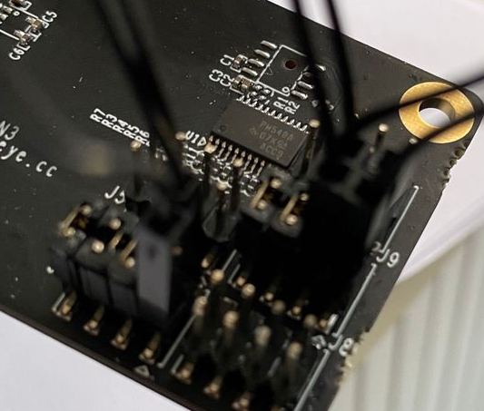

      Now I want install the sync mode. In your manual its described as:
      SYNC signal connection:
      The synchronization signal is connected as shown in the figure above. J5 needs to be connected with J7's 2, 4, 6 and 8pin, and J6 is connected with J8's 2, 4, 6 and 8pin.
      For the schematic diagram of the SYNC signal, please refer to:
      ·          FPD-LINK3-2RX Datasheet
      ·          ADP-N2 Datasheet
      ·          ADP-N3 Datasheet
      But i dont know exactly what to do.
      Can you describe it an in other way. Or do you have an photo of the wiring on the APD-N3 Board?
        veye_xumm @g-towboat last edited by veye_xumm
        @g-towboat
        Hi,
        Accroding to the version log,http://wiki.veye.cc/index.php/CS-MIPI-IMX307_version_log,
        CS-MIPI-IMX307_FV2.33_LV3.3_20201106.bin
        Optimize the sync mechanism by using only frame synchronization signals.
        Fpdlink mode synchronization is supported.
        So the J5 to J8 connection is not necessary anymore. You just need to connect J6 and J8 together, as shown below.
        Please notice the pin1、3、5、7 of J6 and J8 are connected together separately, please use them flexibly.
        http://wiki.veye.cc/index.php/ADP-N3_Data_Sheet_index

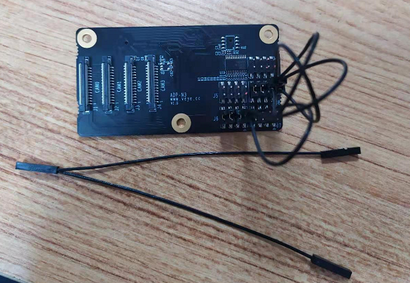

                @g-towboat

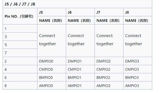

                It's not some pairs of connection. It's a group of connection.
                For example:
                J6-2 is the source of XVS, and J6-4 J6-6 J6-8 J8-2 J8-4 J8-6 J8-8 are all sink of XVS.
                So what you need to do is connect all these pins together.
                J6-1 J6-3 J6-5 J6-7 are already connected together on the board.
                J8-1 J8-3 J8-5 J8-7 are already connected together on the board.
                You can use them if you want.
                G 2 Replies Last reply Reply Quote 0

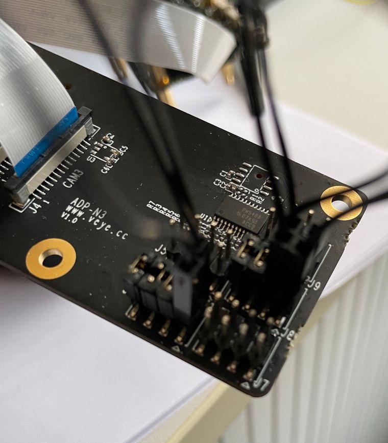

                              @veye_xumm I still have blue Images.
                              Wire configuration standard.
                              Changed as reference in http://forum.veye.cc/topic/22/i-want-to-synchronize-the-two-cameras-in-sync-mode/6?_=1616485571342
                              Can you please check what i am doing wrong or post a detailed photo of the right configuration.
                              Thank you
                                @g-towboat
                                I think you pick out the wrong wire.
                                G 1 Reply Last reply Reply Quote 0

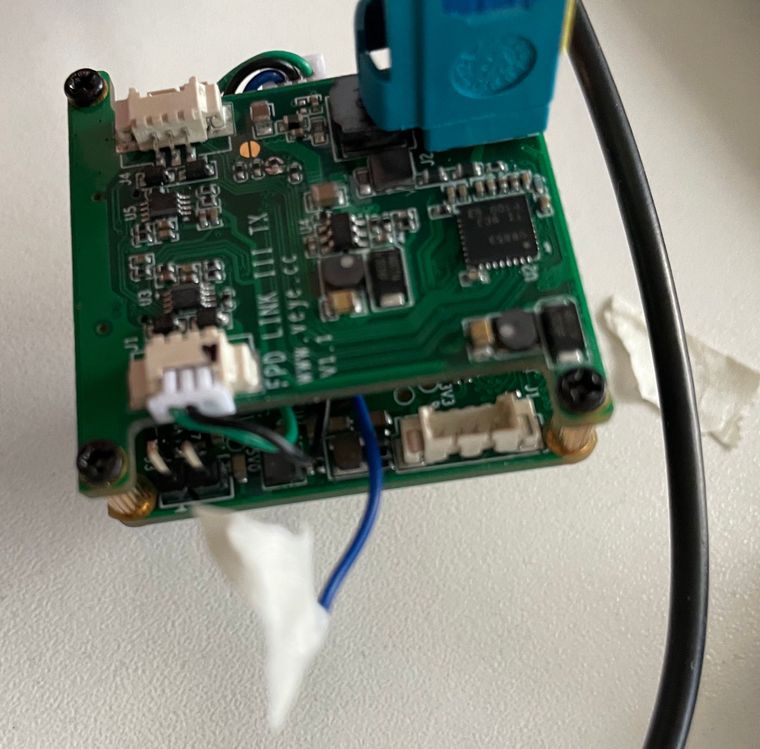

                                  g-towboat @veye_xumm last edited by

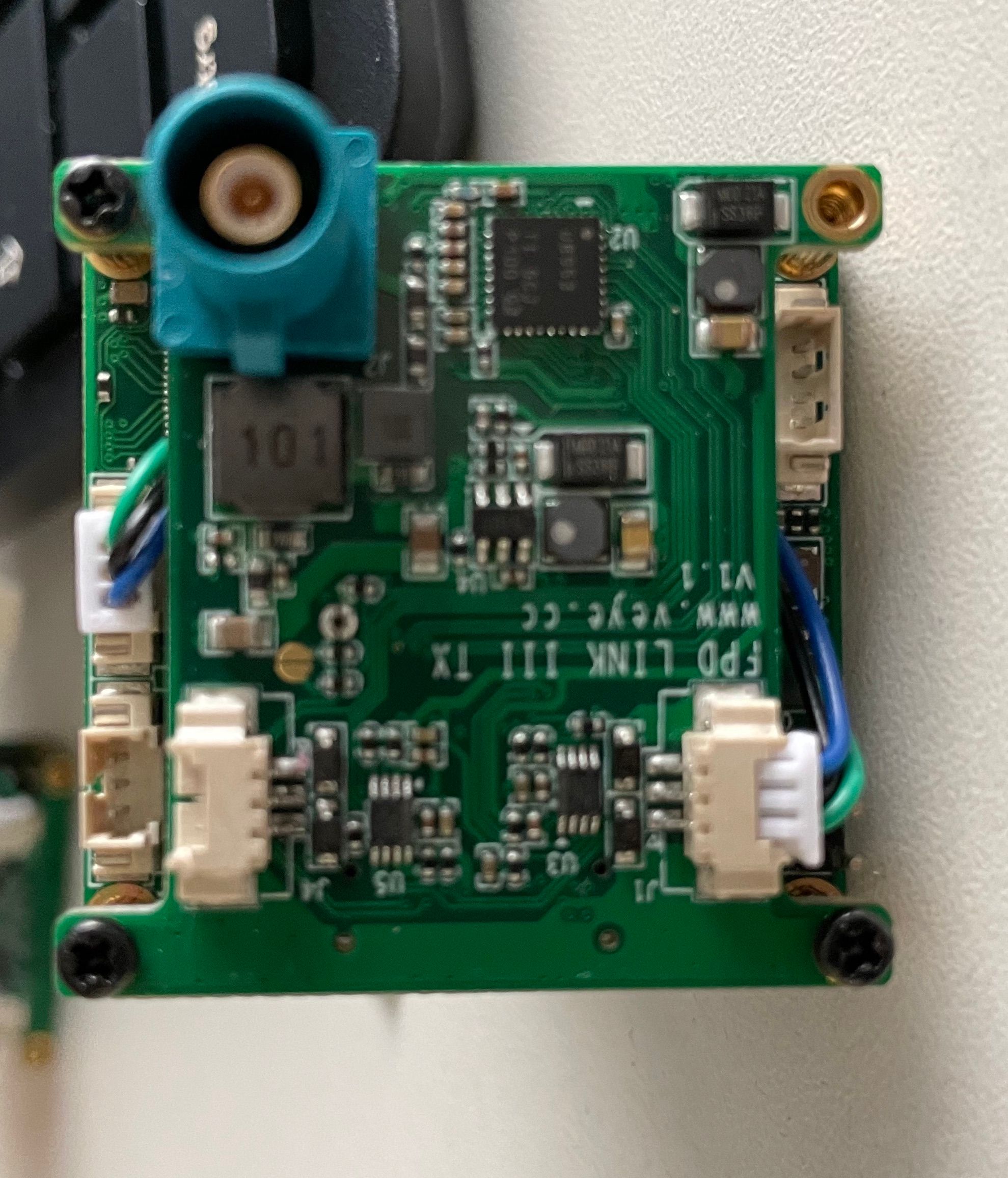

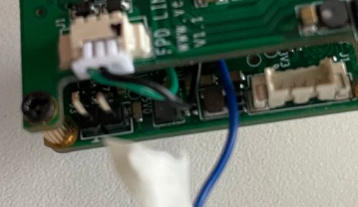

                                  SYNC signal connect:
                                  J7-3 (GPIO0) to J1-3 (GPIO0),
                                  J7-2 (GND) to J1-2 (GND)
                                  Do i need to do the wireing on each camera? or just master camera.
                                  Any other wiring to do?
                                    @g-towboat said in Camera sync mode:
                                    everyone
                                    no
                                    • G
                                      It just work with two cameras but not with 8.
                                      Any other ideas whats wrong ?
                                        @g-towboat
                                        pls check you setting following :http://wiki.veye.cc/index.php/FPD_LINK_III_for_Jetson

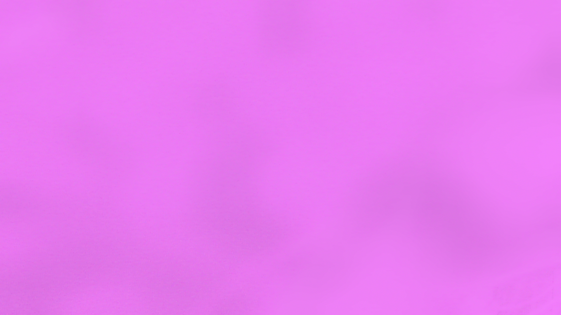

                                          Camera 1 images looks good.
                                          some cameras a purple some are blue!
                                          ![0_1617029969347_frame_1.png](Lade 100% hoch)
                                          Do you need more informations? Or do you have any ideas whats wrong?

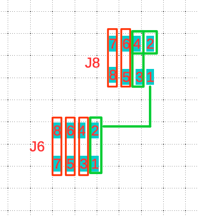

                                            @g-towboat
                                            which one is purple,which one is blue?
                                            I think the script is good. It might be wire connection problem.
                                            Could you draw a sketch of this part? let me have a look.
