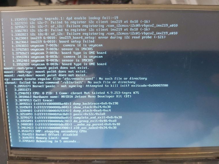

                      cp the files where i needed. i checked the extlinux.conf and could see it was linking up to old arducam dtb, so i updated it and now i get this. its unfortunately not responding and just flashes on the screen.

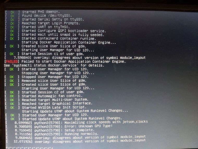

                        Hi @veye_xumm with a fresh sd card i had, i re-did everything in order from the wiki. i am now getting this error. is this due to the extlinux.conf ? 20220920_195437.jpg [0_1663700592838_extlinux.conf](Uploading 100%) [0_1663700657221_extlinux.conf](Uploading 100%) extlinux.txt
                          veye_xumm @rob77 last edited by
                          @rob77 I have a feeling you are correct about Image and dtb.

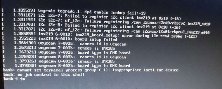

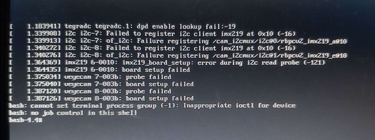

                            @veye_xumm i checked the connections and it seems they are fine now as it is showing ''sensor is IMX385'', but its still not working, i rebuilt the sd card and started from scratch i followed the wiki and checked the conections, all ok. but i am getting this result when rebooting after editing the extlinux.conf. it puts the nano in a constant reboot phase.

                              @rob77 said in VEYE-MIPI-IMX385 on jetson nano:
                              I think there is something wrong with your rootfs.
                              Maybe you have a problem with your tf card? Is there another tf card you can try?
