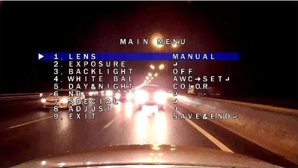

      Hello.
      Already on two copies of the camera VEYE-MIPI-IMX327S, a menu appears:
      The menu cursor moves spontaneously...
      What it is?
      How do I prevent the menu from appearing?

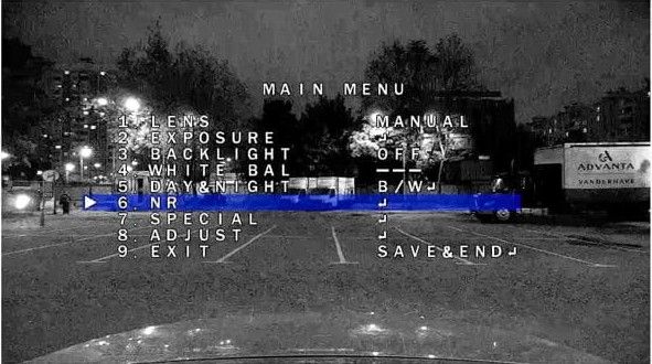

          We do not use MIPI DSI-2 screen. The camera is connected to Raspberry Pi 4 and Raspberry Zero.
          The menu appears randomly
