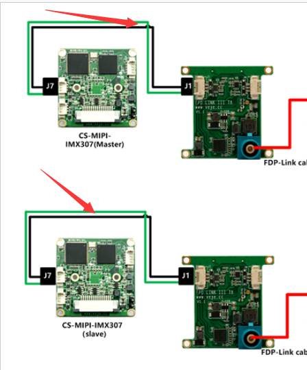

      I want to synchronize the two cameras in sync mode.
      However, I don't think the sync signal is being sent correctly.
      Please let me know what I am doing wrong.
      1. It works fine before the synchronization setting.
      1. The slave side captures a blue image when the synchronization is set as follows.
      # 配置cam0为主
      ./fpdlink3_i2c_jetson.sh -f sync_init -p 0 -p1 0 -b 7
      ./cs_mipi_i2c.sh -w -f streammode -p1 1 -p2 0 -b 7 -d 0x3b
      # 配置cam1为从
      ./fpdlink3_i2c_jetson.sh -f sync_init -p 0 -p1 1 -b 8
      ./cs_mipi_i2c.sh -w -f streammode -p1 1 -p2 1 -b 8 -d 0x3b
      1. The wiring is as follows.

                veye_xumm @octa_yk last edited by
                @octa_yk
                I think you use the wrong pin for SYNC signal. You should use J7-3 and J1-3, not J7-1 and J1-1.
                SYNC signal connect J7-3 to J1-3,J7-2 to J1-2.
                O 1 Reply Last reply Reply Quote 0
