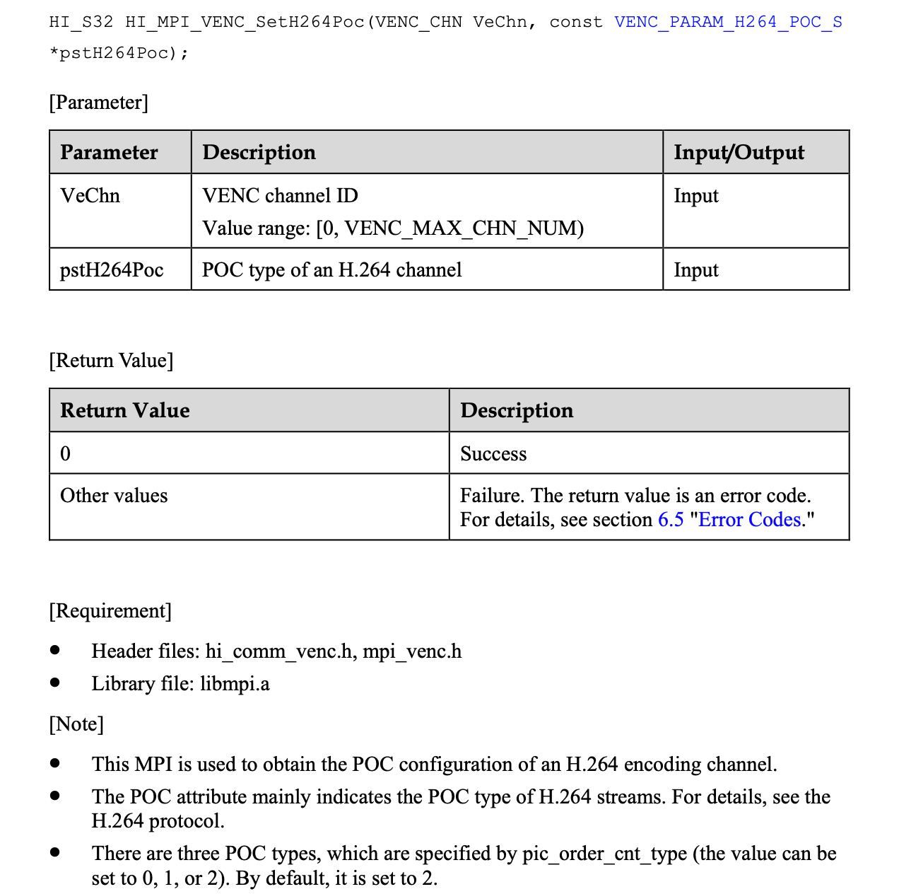

          When I search the firmware for the Hi3516v200 I find the following reference
          h264e_set_poc
          inside
          hi3516ev200_h264.ko
          poc pretty much always stands for "pic_order_count_type" in this context.
          So I doubt it is a hardware limitation by the encoder.
          Especially since there is also the following comment:
          pic_order_cnt_type err, should in [0,2]
          e.g. poc_type can be in the range [0,2] where 2 is what I was asking for.
          • P

                      Thank you for this conclusive response. Maybe your subsidary who provides the sw for the encoder chip can do something though -
                      From the official documentation for Hi3518 i found out that they actually use poc_type=2 by default.
                      So it is likely that the sw you are using is manually setting poc_type=0.
                      For the OpenHD project, we test a lot of usb cameras. They all share the poc_type bug though (I refer to it as bug here, because it makes the camera unusable for low latency streaming on a lot of platforms).
                      Whoever is the first one to bring a usb camera to market with HiXXX chip and poc_type=2 basically has the lowest latency h264 usb camera on the market paired with rpi or snapdragon as decoder.
