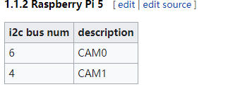

                                      any chances use configuration script ./veye_mipi_i2c.sh on RPi5?
                                      No. Just pay attention to i2c bus number.
                                      V A 2 Replies Last reply Reply Quote 0

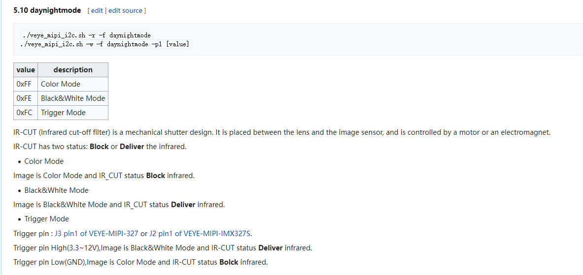

                                        Vaa @veye_xumm last edited by
                                        @veye_xumm This is not clear to me. For example, how can I switch Infrared filter on/off then? It seems to me the veye_mipi_i2c.sh script is not working at all.
                                          veye_xumm @Vaa last edited by
                                          @vaa
                                          In addition to this, the -b parameter needs to be added:
                                          -b [i2c bus num] i2c bus number
                                          V 1 Reply Last reply Reply Quote 0

                                            Vaa @veye_xumm last edited by Vaa
                                            @veye_xumm Thank you for your support!
                                            I got my application working good.
                                            Here is a receipt how can I achived this:
                                            1. ./media_setting_rpi5.sh veyecam2m
                                            2. ./veye_mipi_i2c.sh -b 6 -w -f yuvseq -p1 YUYV
                                            3. ./veye_mipi_i2c.sh -b 6 -w -f videoformat -p1 PAL
                                            4. In my app open device /dev/video0 with following parameters:
                                              width 1920;
                                              height 1080;
                                              pixel_format V4L2_PIX_FMT_UYVY (only this is working!!!)
                                              field_format V4L2_FIELD_NONE
                                            In case I try to set pixel_format to any other value is cause VIDIOC_STREAMON fail. I suppose this is a bug in the driver.
                                            Some other applications like gstreamer only set pixel_format if you directly point to do this, this is why it works, but many others (e.g. trying to set default pixel_format) are not.
                                            V 1 Reply Last reply Reply Quote 1
