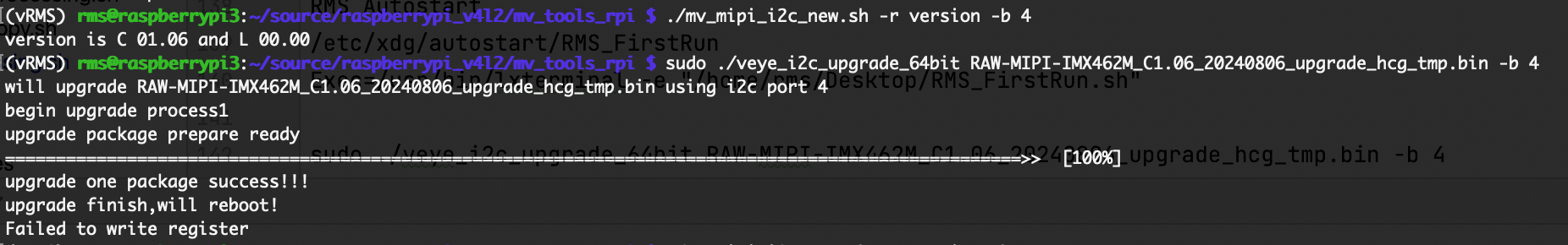

    • RE: IMX462M pixelformat on RPi5
      Hi, thank you for firmware update.
      Just to double check, is HCG mode always turn on now?
      Also for register 0x3009 I got value 0xffff instead ox11 but seems like HCG enabled anyway.
      I need wait for clear sky to test and provide feedback
      PS:
      After upgrade at the end it writes: "Failed to write register" message but upgrade done , can I just ignore it?
      posted in Machine Vision camera

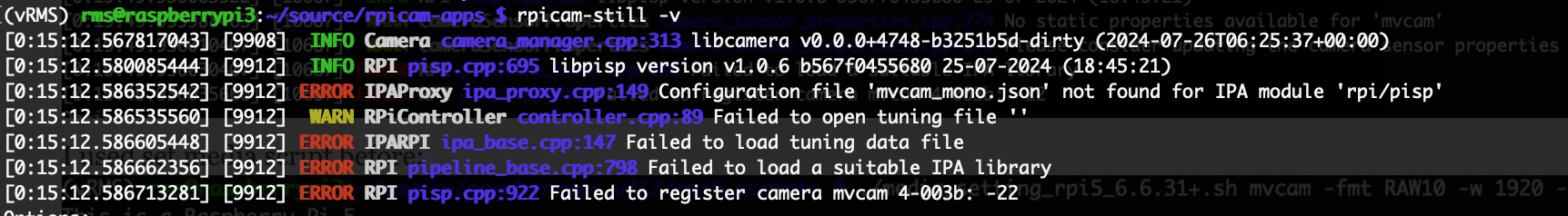

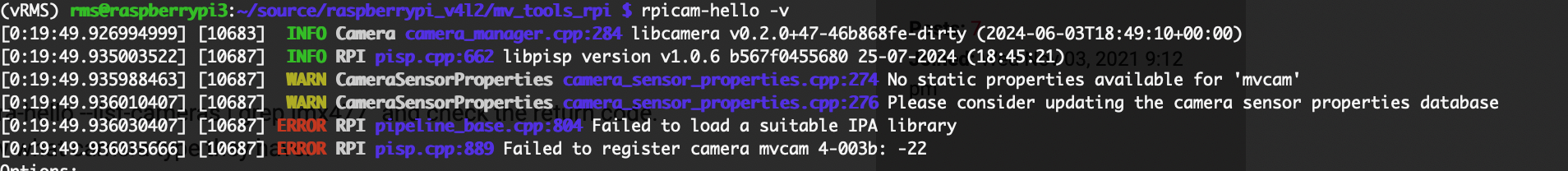

      Hi, I noticed that version of libcamera different on my screenshot (it 0.2.0 but I installed 0.3.0)
      I uninstalled rpicam-apps and rebuild it from source code again and it uses my version of libcamera now.
      if execute rpicam-still -v I have next error:
      In commit I see added json file only to vc4 folder (for RPi4) , can we add it to pisp folder (for RPi5) it should have name : "mvcam_mono.json"? it has different format and can't use same file from vc4.
      Also I managed start video by this command:
      rpicam-still --tuning-file /source/libcamera/src/ipa/rpi/pisp/data/uncalibrated.json -t 0
      and it works!

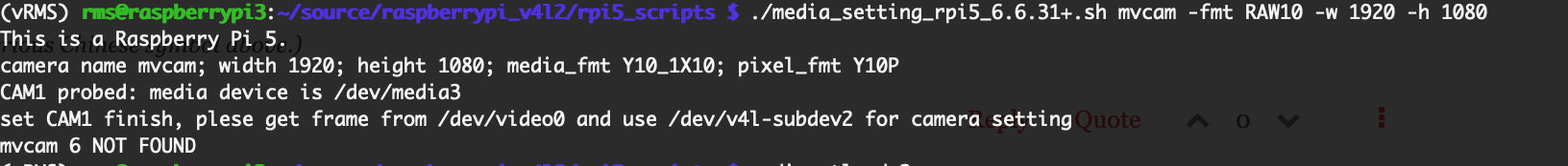

      Hi, it helped but I had to use 1.0.6 tag of libpisp, with the latest version I had compile errors.
      Now for command : rpicam-hello -v
      I have this error:
      I used set media script before:
      Maybe forgot something else.
