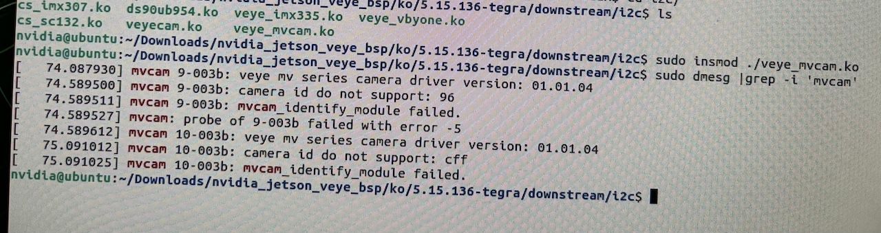

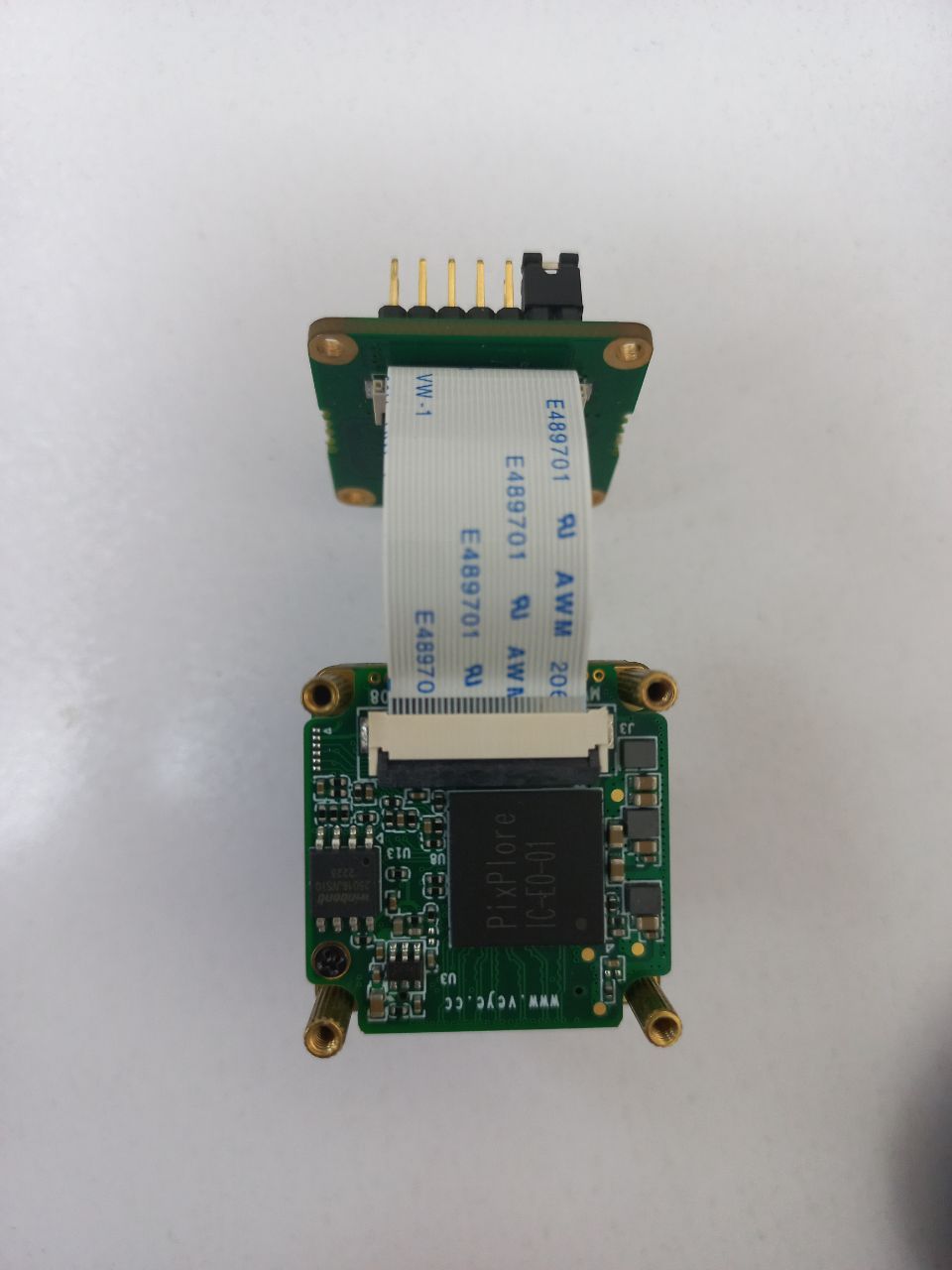

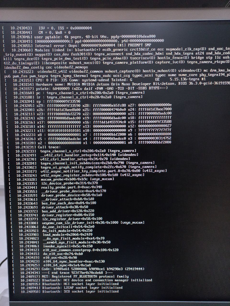

              @veye_xumm Hi i have read all the wiki and downloaded https://github.com/veyeimaging/nvidia_jetson_veye_bsp
              but I am still missing dtb file for MV-MIPI-IMX264.
              I have bought 4 of them and I have tried so many times. still I cannot make use of one of those.
              I have install all the drivers and other steps i just need dtb file
              OS: ubuntu 22.04
              jeton orin nano Jetpack6.0,L4T r36.3
              please help me
              thanks
              O 1 Reply Last reply Reply Quote 0

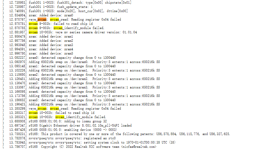

                Otca @Otca last edited by
                @otca
                cat /etc/nv_tegra_release
                R36 (release), REVISION: 3.0, GCID: 36191598, BOARD: generic, EABI: aarch64, DATE: Mon May 6 17:34:21 UTC 2024
                KERNEL_VARIANT: oot
                TARGET_USERSPACE_LIB_DIR=nvidia
                TARGET_USERSPACE_LIB_DIR_PATH=usr/lib/aarch64-linux-gnu/nvidia
                dmesg | grep -i 'fail'
                [ 5.067860] hid-generic: probe of 0003:1C4F:0202.0002 failed with error -22
                [ 9.577266] videodev: module verification failed: signature and/or required key missing - tainting kernel
                [ 11.795964] dce: dce_admin_setup_clients_ipc:561 Get queue info failed for [2]
                [ 12.536169] veye_mvcam: mvcam_read: Reading register 0x04 failed
                [ 12.536185] mvcam 9-0010: failed to read chip id
                [ 12.536190] mvcam 9-0010: mvcam_identify_module failed.
                [ 13.041253] veye_mvcam: mvcam_read: Reading register 0x04 failed
                [ 13.041269] mvcam 10-0010: failed to read chip id
                [ 13.041273] mvcam 10-0010: mvcam_identify_module failed.
                [ 16.965874] NVRM rpcRmApiControl_dce: NVRM_RPC_DCE: Failed RM ctrl call cmd:0x731341 result 0xffff:
                dmesg | grep -i 'veye'
                [ 12.031976] mvcam 9-0010: veye mv series camera driver version: 01.01.04
                [ 12.539516] mvcam 10-0010: veye mv series camera driver version: 01.01.04
                dmesg | grep -i 'error'
                [ 9.363672] squashfs: SQUASHFS error: Xattrs in filesystem, these will be ignored
                [ 9.365895] squashfs: SQUASHFS error: Xattrs in filesystem, these will be ignored
                [ 9.369376] squashfs: SQUASHFS error: Xattrs in filesystem, these will be ignored

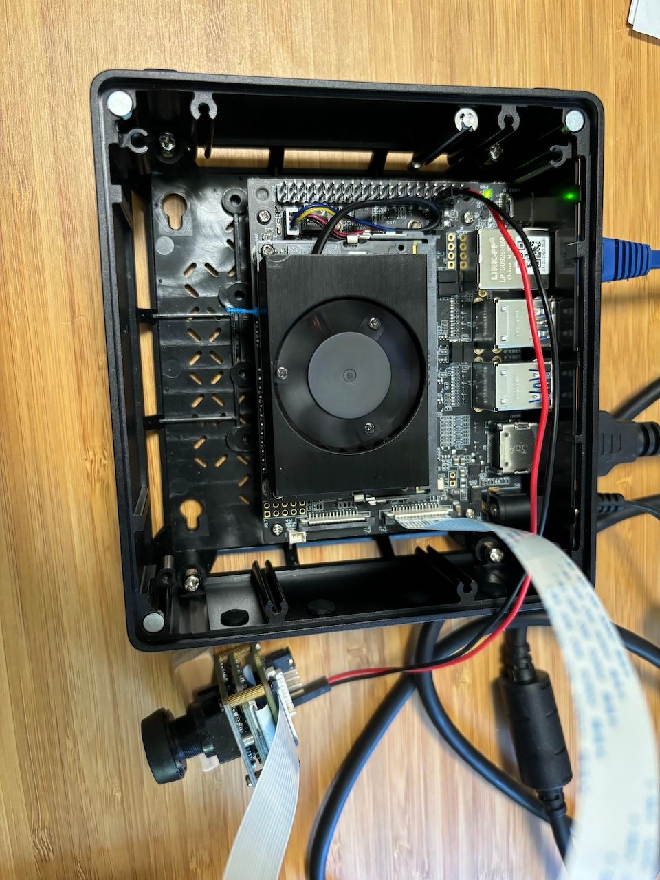

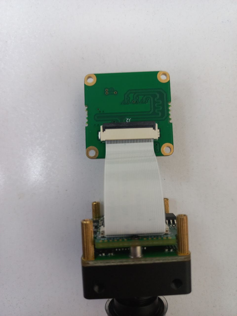

                  veye_xumm @Otca last edited by
                  @otca said in NVidia Jetson Jetpack 6 support?:

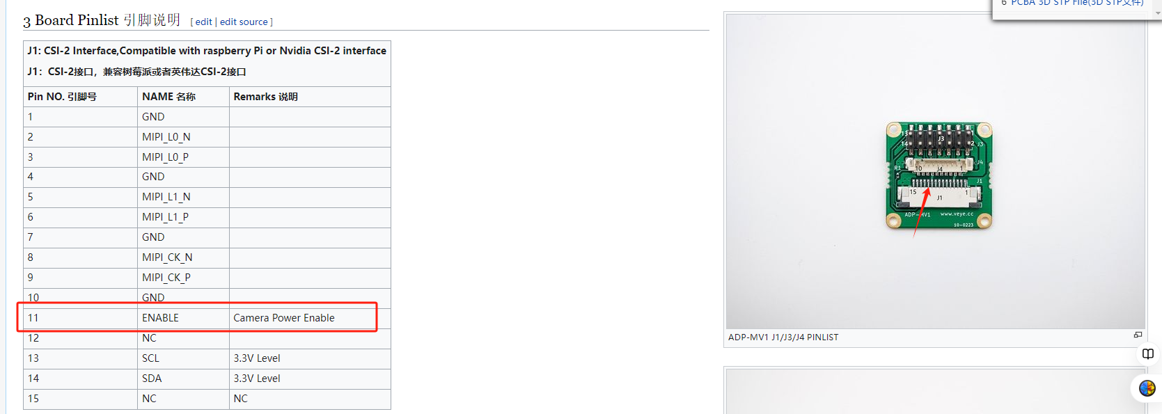

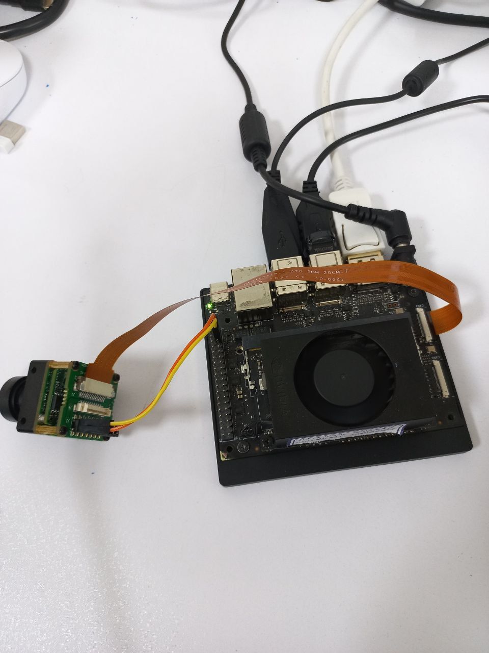

                  From this prompt message, it looks like your driver and dtb are doing the right thing. But now i2c probe can't get the device.
                  Please make sure your 5V dupont cable is plugged into the right place? I can't see it clearly from the picture.

                    Otca @veye_xumm last edited by
                    @veye_xumm said in NVidia Jetson Jetpack 6 support?:
                    5V dupon
                    Thnaks for fast replay
                    To double check the pin of IMX264 would u please tell me which one is 5V and which one is GND?
                    • O
                      @otca I just checked the connection and I'm sure that 5V and GND connection are OK.
                      any idea what to do?

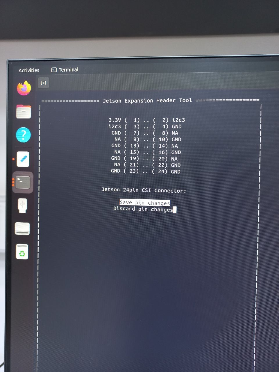

                            Please run cat /etc/extlinux/extlinux.conf, and paste here.
                            O 2 Replies Last reply Reply Quote 0
                                  [ 11.782990] mvcam 9-003b: veye mv series camera driver version: 01.01.04
                                  [ 12.284602] veye_mvcam: mvcam_read: Reading register 0x04 failed
                                  [ 12.286011] mvcam 10-003b: veye mv series camera driver version: 01.01.04
                                  [ 12.795113] veye_mvcam: mvcam_read: Reading register 0x04 failed
                                  veye_xumm 2 Replies Last reply Reply Quote 0
                                    @otca
                                    I would say that this phenomenon now has nothing to do with the details of the dts. The problem now is that i2c doesn't work.
                                    This is often something to do with the hardware connection cables, and whether the camera is working properly.
                                    Do you have a multimeter? An oscilloscope? Can you measure the power supply to the camera module, and whether the i2c communication is working?
                                      @otca
                                      Have you ever disassembled the camera module?Is the direction of the internal FFC flex cable correct?
                                      • O
                                        I have not disassembled camera but if you think i should disassemble and check connections, I'll give it a try.
                                        if its possible please give me reference needed for this part.
                                        and for the other question, I did check the power supply and it was 5.14 V.
                                        • O
                                            @otca
                                            There's nothing wrong with that in my opinion. You have 4 cameras, have you tried any others?
                                            Or try plugging the camera into another mipi port ?
