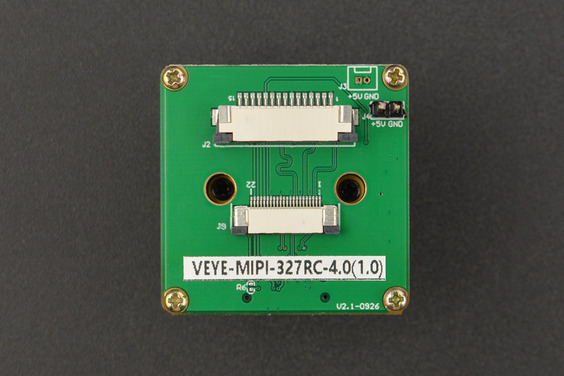

      Hello , Iam trying to setup my camera modulebought from Dfrobot , on my raspberry pi 5 , Linux raspberrypi 6.6.51+rpt-rpi-2712 #1 SMP PREEMPT Debian 1:6.6.51-1+rpt3 (2024-10-08) aarch64 GNU/Li , but i cant find this version in the github files when i download it and when i try to use the command i get this
      usage: ./install_driver_rpi5.sh veyecam2m/csimx307/cssc132/veye_mvcam/veye_vbyone/ds90ub954
      This is a Raspberry Pi 5.
      CONFIG_FILE: /boot/firmware/config.txt
      Enable i2c adapter... pls use i2c-4 for cam1, i2c-6 for cam0
      Add dtoverlay=veyecam2m to /boot/firmware/config.txt
      Installing the veyecam2m.ko driver
      install: cannot stat './driver_bin/6.6.51+rpt-rpi-2712/veyecam2m.ko': No such file or directory
      install: cannot stat './driver_bin/6.6.51+rpt-rpi-2712/veyecam2m.dtbo': No such file or directory
      reboot now?(y/n):
      , is this version of the raspberry pi not supported yet or what is the solution have been trying and following the wiki for 3 days
