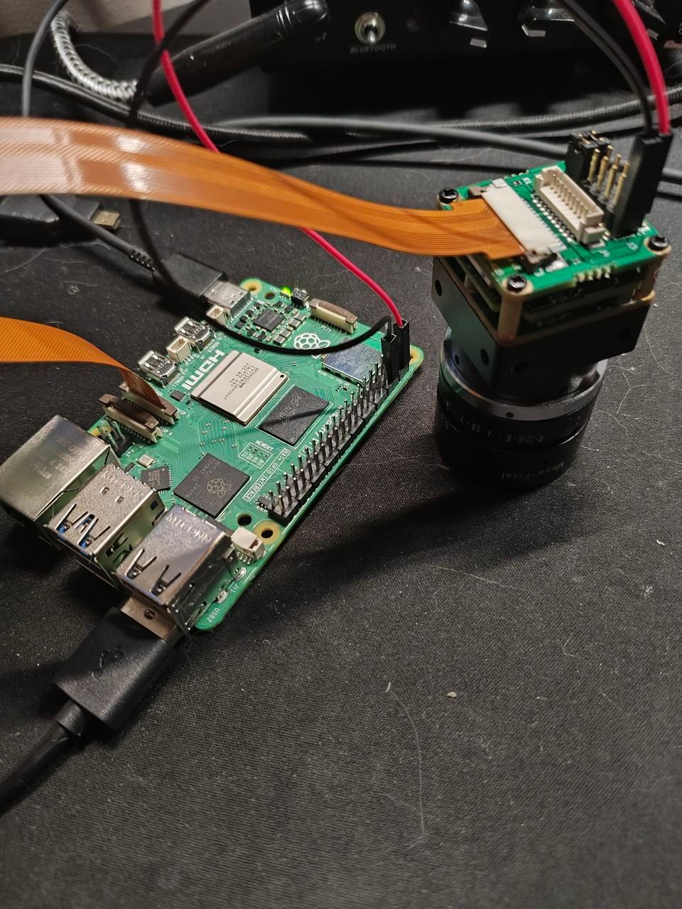

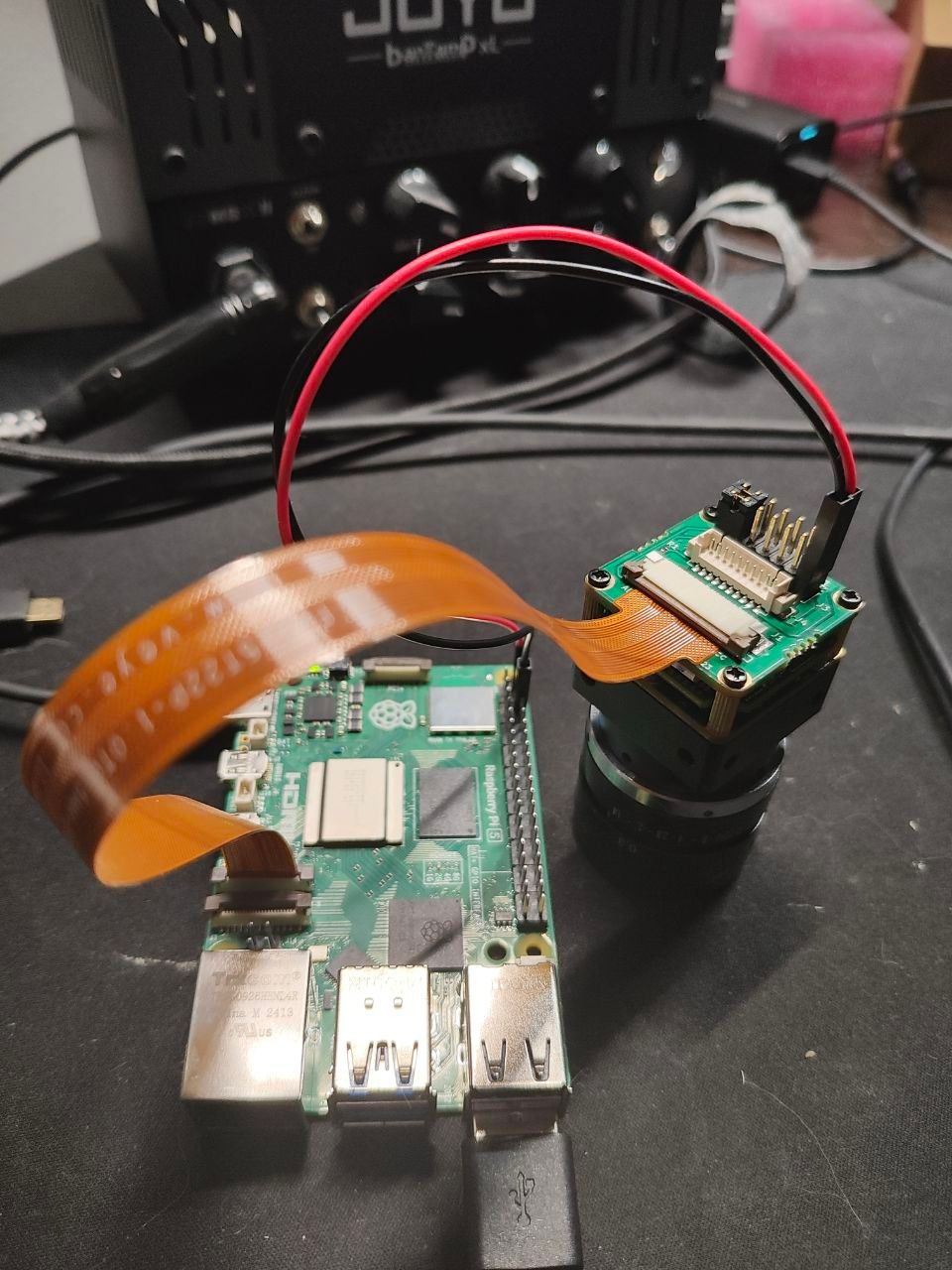

      Did anyone try to setup this camera module on rpi zero 2w?
      UPD: I have the same error with rpi5 (used install_driver_rpi5.sh instead of install_driver.sh). I've checked my cable connections and everything looks correct (please correct me if I'm wrong)
      UPD2: SOLVED. The problem was that I've tried to put ribbon cable under brown plastic thing. Ribbon should go above it, and contacts should be faced up, not to the board. Like this:
      And this is wrong:

          Unfortunately I cannot test it with rpi5 since something is not working with rpi5:
          user@rpi5:~/raspberrypi_v4l2/rpi5_scripts $ ./media_setting_rpi5.sh mvcam
          This is a Raspberry Pi 5.
          Kernel version is 6.6.74, do not support unpacked format.
          Kernel version is 6.6.74, use i2c-10 for CAM0 and i2c-11 for CAM1.
          camera name mvcam; roi_x 0; roi_y 0;width 1280; height 1024; media_fmt Y8_1X8; pixel_fmt GREY
          mvcam 11 NOT FOUND
          CAM0 probed:  media device is  /dev/media1
          set CAM0 finish, plese get frame from /dev/video0 and use /dev/v4l-subdev2 for camera setting
          user@rpi5:~/raspberrypi_v4l2/rpi5_scripts $ v4l2-ctl --stream-mmap --stream-count=-1 -d /dev/video0 --stream-to=/dev/null
          		VIDIOC_STREAMON returned -1 (Broken pipe)
          user@rpi5:~/raspberrypi_v4l2/rpi5_scripts $ uname -a
          Linux rpi5 6.6.74+rpt-rpi-2712 #1 SMP PREEMPT Debian 1:6.6.74-1+rpt1 (2025-01-27) aarch64 GNU/Linux
          user@rpi5:~/raspberrypi_v4l2/rpi5_scripts $ dmesg | grep -E "rp1|cam"
          [    0.889753] /axi/pcie@120000/rp1: Fixed dependency cycle(s) with /axi/pcie@120000/rp1
          [    0.897628] /axi/pcie@120000/rp1/i2c@80000/veyemvcam@3b: Fixed dependency cycle(s) with /axi/pcie@120000/rp1/csi@128000
          [    0.908463] /axi/pcie@120000/rp1/i2c@88000/veyemvcam@3b: Fixed dependency cycle(s) with /axi/pcie@120000/rp1/csi@110000
          [    0.919310] /axi/pcie@120000/rp1/csi@110000: Fixed dependency cycle(s) with /axi/pcie@120000/rp1/i2c@88000/veyemvcam@3b
          [    0.930143] /axi/pcie@120000/rp1/csi@128000: Fixed dependency cycle(s) with /axi/pcie@120000/rp1/i2c@80000/veyemvcam@3b
          [    0.951482] /axi/pcie@120000/rp1: Fixed dependency cycle(s) with /axi/pcie@120000/rp1
          [    0.959356] /axi/pcie@120000/rp1/i2c@80000/veyemvcam@3b: Fixed dependency cycle(s) with /axi/pcie@120000/rp1/csi@128000
          [    0.970192] /axi/pcie@120000/rp1/i2c@88000/veyemvcam@3b: Fixed dependency cycle(s) with /axi/pcie@120000/rp1/csi@110000
          [    0.981040] /axi/pcie@120000/rp1/csi@110000: Fixed dependency cycle(s) with /axi/pcie@120000/rp1/i2c@88000/veyemvcam@3b
          [    0.991874] /axi/pcie@120000/rp1/csi@128000: Fixed dependency cycle(s) with /axi/pcie@120000/rp1/i2c@80000/veyemvcam@3b
          [    2.094202] rp1 0000:01:00.0: bar0 len 0x4000, start 0x1f00410000, end 0x1f00413fff, flags, 0x40200
          [    2.103288] rp1 0000:01:00.0: bar1 len 0x400000, start 0x1f00000000, end 0x1f003fffff, flags, 0x40200
          [    2.112551] rp1 0000:01:00.0: enabling device (0000 -> 0002)
          [    2.118840] rp1 0000:01:00.0: chip_id 0x20001927
          [    2.127268] /axi/pcie@120000/rp1/i2c@80000/veyemvcam@3b: Fixed dependency cycle(s) with /axi/pcie@120000/rp1/csi@128000
          [    2.138171] /axi/pcie@120000/rp1/i2c@88000/veyemvcam@3b: Fixed dependency cycle(s) with /axi/pcie@120000/rp1/csi@110000
          [    2.149346] genirq: irq_chip rp1_irq_chip did not update eff. affinity mask of irq 100
          [    2.186472] /axi/pcie@120000/rp1/i2c@88000/veyemvcam@3b: Fixed dependency cycle(s) with /axi/pcie@120000/rp1/csi@110000
          [    2.197319] /axi/pcie@120000/rp1/csi@110000: Fixed dependency cycle(s) with /axi/pcie@120000/rp1/i2c@88000/veyemvcam@3b
          [    2.208238] /axi/pcie@120000/rp1/i2c@80000/veyemvcam@3b: Fixed dependency cycle(s) with /axi/pcie@120000/rp1/csi@128000
          [    2.219089] /axi/pcie@120000/rp1/csi@128000: Fixed dependency cycle(s) with /axi/pcie@120000/rp1/i2c@80000/veyemvcam@3b
          [    2.977111] rp1-pio 1f00178000.pio: error -ENOENT: failed to contact RP1 firmware
          [    2.985152] rp1-pio: probe of 1f00178000.pio failed with error -2
          [    8.298688] rp1-firmware rp1_firmware: RP1 Firmware version eb39cfd516f8c90628aa9d91f52370aade5d0a55
          [    9.308331] rp1-cfe 1f00110000.csi: bcm2712_iommu_of_xlate: MMU 1000005280.iommu
          [    9.310361] rp1-cfe 1f00110000.csi: DW dphy Host HW v1.20
          [    9.310370] rp1-cfe 1f00110000.csi: PiSP FE HW v0.1
          [    9.310407] rp1-cfe 1f00110000.csi: found subdevice /axi/pcie@120000/rp1/i2c@88000/veyemvcam@3b
          [    9.310541] rp1-cfe 1f00128000.csi: bcm2712_iommu_of_xlate: MMU 1000005280.iommu
          [    9.310844] rp1-cfe 1f00128000.csi: DW dphy Host HW v1.20
          [    9.310851] rp1-cfe 1f00128000.csi: PiSP FE HW v0.1
          [    9.310889] rp1-cfe 1f00128000.csi: found subdevice /axi/pcie@120000/rp1/i2c@80000/veyemvcam@3b
          [    9.460081] veye_mvcam: loading out-of-tree module taints kernel.
          [    9.461064] mvcam 11-003b: veye mv series camera driver version: 01.01.06
          [   10.076168] mvcam: mvcam_read: Reading register 0x04 failed
          [   10.076174] mvcam 11-003b: failed to read chip id
          [   10.076312] mvcam 10-003b: veye mv series camera driver version: 01.01.06
          [   10.580424] mvcam 10-003b: camera is: MV_MIPI_IMX287M
          [   10.581213] mvcam 10-003b: firmware version: 0x1430207
          [   10.585920] mvcam 10-003b: Success to get mvcam endpoint data lanes, dts uses 2 lanes,will set to camera
          [   10.595802] mvcam 10-003b: mvcam_enum_controls success
          [   10.597180] rp1-cfe 1f00110000.csi: Using sensor mvcam 10-003b for capture
          [   10.597254] rp1-cfe 1f00110000.csi: Registered [rp1-cfe-csi2_ch0] node id 0 successfully as /dev/video0
          [   10.597279] rp1-cfe 1f00110000.csi: Registered [rp1-cfe-embedded] node id 1 successfully as /dev/video1
          [   10.597299] rp1-cfe 1f00110000.csi: Registered [rp1-cfe-csi2_ch2] node id 2 successfully as /dev/video2
          [   10.597320] rp1-cfe 1f00110000.csi: Registered [rp1-cfe-csi2_ch3] node id 3 successfully as /dev/video3
          [   10.597345] rp1-cfe 1f00110000.csi: Registered [rp1-cfe-fe_image0] node id 4 successfully as /dev/video4
          [   10.597364] rp1-cfe 1f00110000.csi: Registered [rp1-cfe-fe_image1] node id 5 successfully as /dev/video5
          [   10.597388] rp1-cfe 1f00110000.csi: Registered [rp1-cfe-fe_stats] node id 6 successfully as /dev/video6
          [   10.597407] rp1-cfe 1f00110000.csi: Registered [rp1-cfe-fe_config] node id 7 successfully as /dev/video7
          [  240.263269] rp1-cfe 1f00110000.csi: Failed to start media pipeline: -32
          Thanks in advance
            veye_xumm @nkos last edited by
            @nkos
            Please try this on rpi5:
            export WIDTH=704
            export HEIGHT=544
            export FPS=319
            ./media_setting_rpi5.sh mvcam -fmt RAW8 -x 8 -y 8 -w $WIDTH -h $HEIGHT
            v4l2-ctl --set-ctrl roi_x=8 -d /dev/v4l-subdev2
            v4l2-ctl --set-ctrl roi_y=8 -d /dev/v4l-subdev2
            v4l2-ctl --set-fmt-video=width=$WIDTH,height=$HEIGHT
            v4l2-ctl --set-ctrl frame_rate=$FPS  -d /dev/v4l-subdev2
            v4l2-ctl -d /dev/video0 --set-fmt-video=width=$WIDTH,height=$HEIGHT,pixelformat=GREY --stream-mmap --stream-count=-1 --stream-to=/dev/null
            N 2 Replies Last reply Reply Quote 0
            • N
              nkos @veye_xumm last edited by nkos
              works, thanks. fps is fine as well, 522.65
