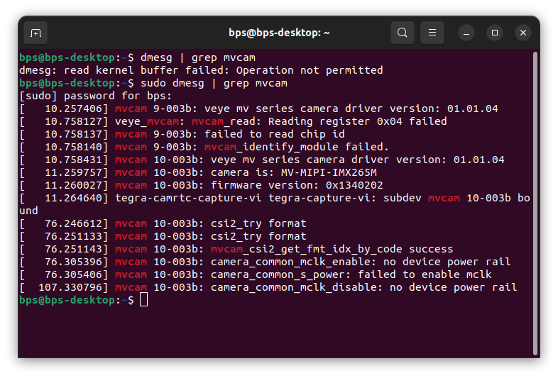

      Hello
      I installed the imx265 camera drivers on the A603 board from seeedstudio with Jetson orin nx 8gb and Jetpack 36.4.0 but it doesn't give me an image. In the image below I put the output of the dmesg:Screenshot from 2025-07-09 18-20-43.png
