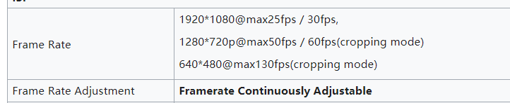

      how to use the Sensor crop mode of the IMX307 Camera.
      Thanks a lot
        veye_xumm @g-towboat last edited by
        @g-towboat
        Crop mode can be achieved by setting the resolution to 1280* 720 mode.
        http://wiki.veye.cc/index.php/CS-MIPI-X_i2c#videofmt

          @veye_xumm is it possible to set other video formats? for example when i change the devicetree?

            CS-MIPI-IMX307 support 3 video formats:
            Please check the datasheet:
            http://wiki.veye.cc/index.php/CS-MIPI-IMX307_STARVIS_Module
            G 1 Reply Last reply Reply Quote 0
            • G
              g-towboat @veye_xumm last edited by
              @veye_xumm ok i am understand, just these three formats
