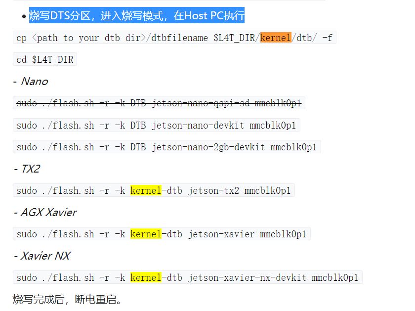

            • W
              wzy @veye_xumm last edited by
              kernel文件夹在哪个位置
              flash.sh文件在哪。我都没有找到

                    • W
                      @veye_xumm 是把Xavier下载的dtb文件拷贝到Host pc 的/kernel/dtb/文件里,然后在执行flash脚本就ok了?
                        veye_xumm @wzy last edited by
                        @wzy
                        是的,详细步骤请参考wiki

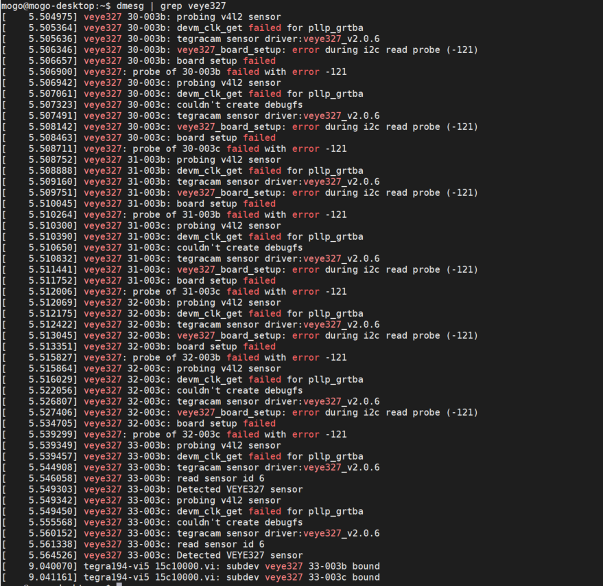

                          执行dmesg | grep veye327 后的结果,是这样的。是哪出了问题吗?

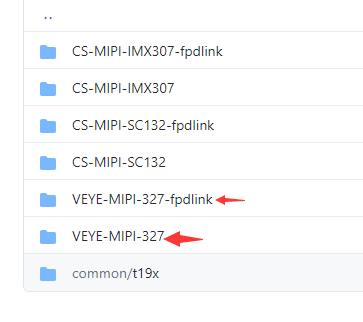

                            @wzy 我看你用的是fpdlink接口的327,应该用fpdlink目录下的dtb文件。
                            • W
                              @veye_xumm said in 签名文件:
                              fpdlink目录下的dtb文件
                              这个文件的路径在哪?拷贝到host pc,再烧一遍?
                                在github的dtb目录,如图。上面这个fpdlink的指的是veye327-fpdlink的型号。 你需要用这个目录下的dtb。

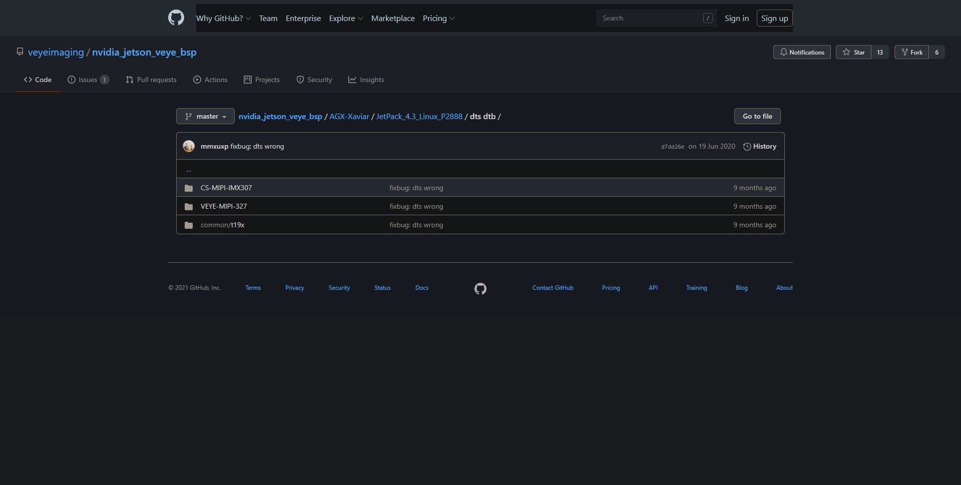

                                • W
                                  怎么没找到啊?你给复制个完整的git地址

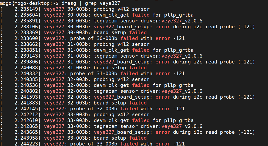

                                    wzy @wzy last edited by

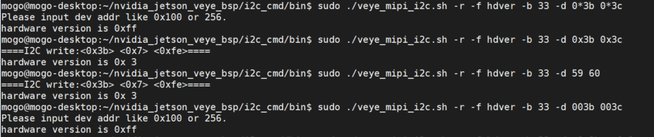

                                    我用4.4的版本试过了,还是报的这个错!测试脚本也没有跑起来。
                                    mogo@mogo-desktop:~/nvidia_jetson_veye_bsp/i2c_cmd/bin$ ./veye_mipi_i2c.sh -r -f devid
                                    -bash: ./veye_mipi_i2c.sh: Permission denied
                                    报错

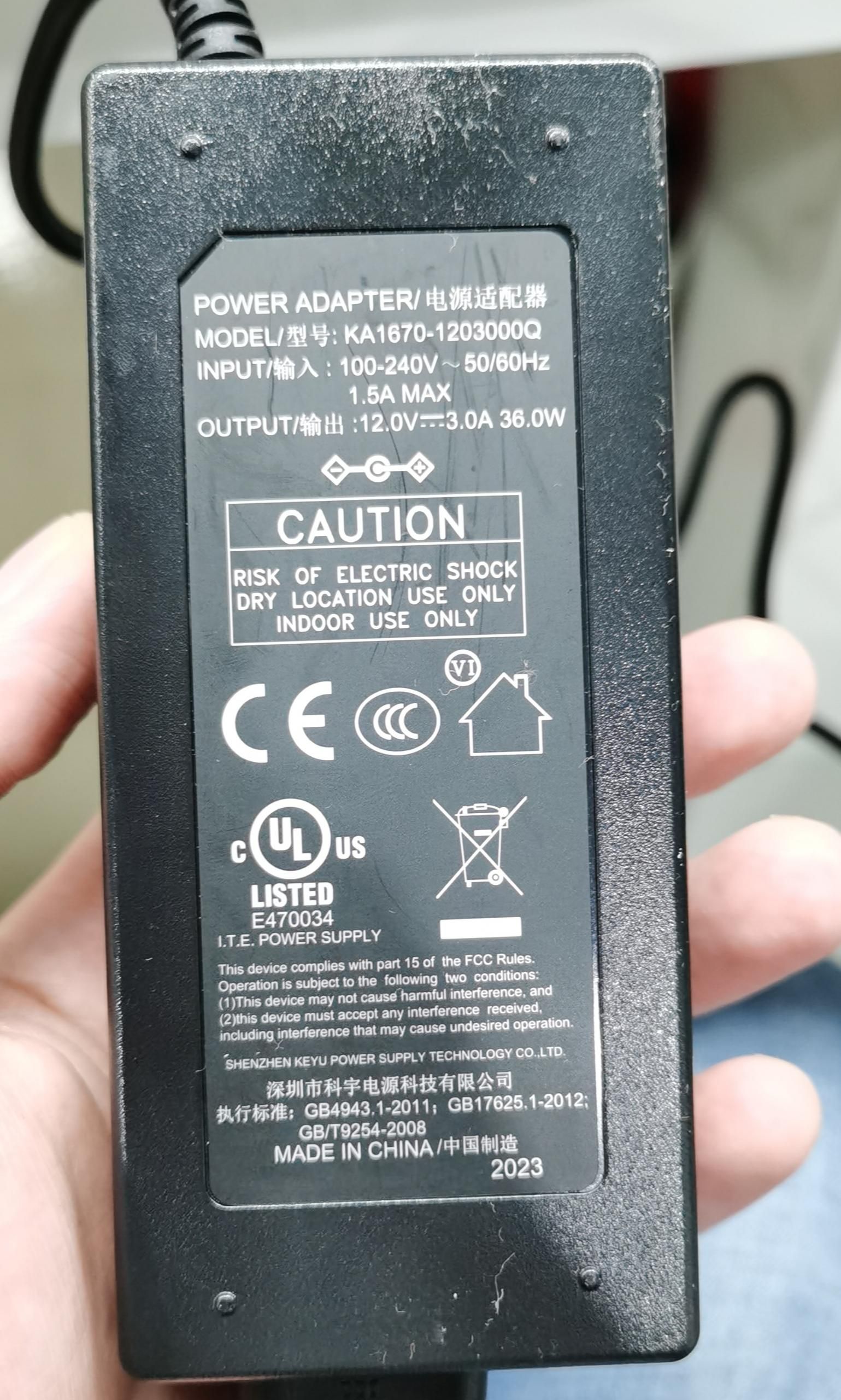

                                      @wzy
                                      请参考这个,注意提供12V供电,注意fpc排线方向。
                                      http://wiki.veye.cc/index.php/CS-FPD-XAVIER-nCAM_Series
                                      @wzy said in 签名文件:
                                      这个要加一个可执行权限
                                      chmod +x *
                                      主要为了将参数配置到特定的camera,要用-b [busnum]参数,-d [address]参数。

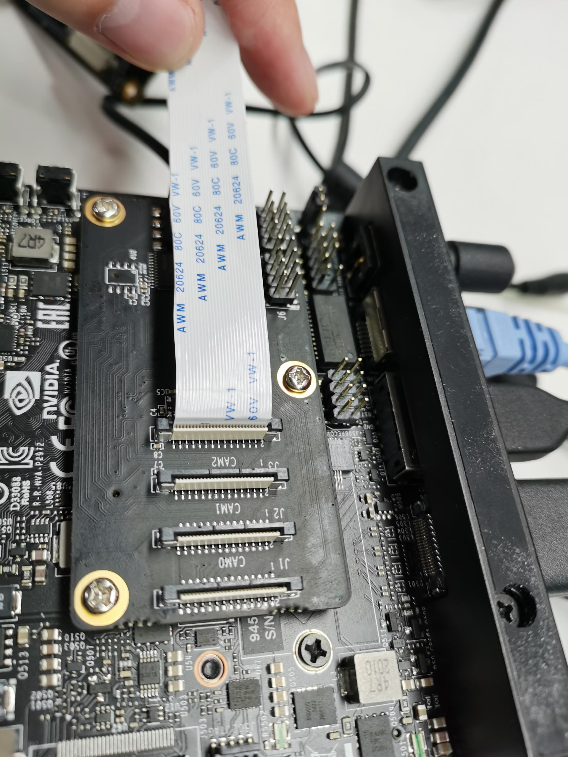

                                      • W
                                        @veye_xumm 7f31846d5eb849472e4b62694130050b.jpg 69e901e360daaaa2c34dfbc9d448a92d.jpg 505beced9133b51644c5e43566cf8e09.jpg ![bd6079d0e15858414404b8cc037911a3.jpg](/assets/uploads/files/1616144144423-
                                        bd6079d0e15858414404b8cc037911a3.jpg)
                                        还是报那个错误!
                                          @wzy
                                          把整个dmesg打印的东西导出来保存到文件里面,作为附件贴上来看一下。

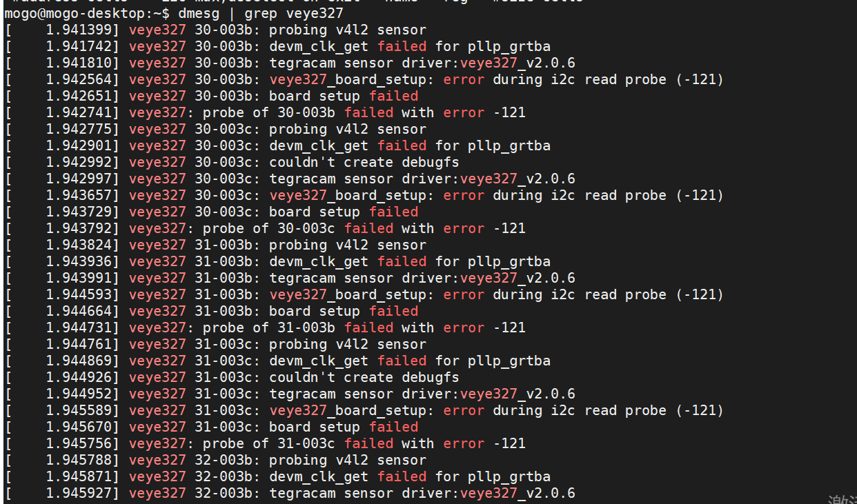

                                          • W
                                            mogo@mogo-desktop:~$ dmesg | grep veye327
                                            [ 1.941399] veye327 30-003b: probing v4l2 sensor
                                            [ 1.941742] veye327 30-003b: devm_clk_get failed for pllp_grtba
                                            [ 1.941810] veye327 30-003b: tegracam sensor driver:veye327_v2.0.6
                                            [ 1.942564] veye327 30-003b: veye327_board_setup: error during i2c read probe (-121)
                                            [ 1.942651] veye327 30-003b: board setup failed
                                            [ 1.942741] veye327: probe of 30-003b failed with error -121
                                            [ 1.942775] veye327 30-003c: probing v4l2 sensor
                                            [ 1.942901] veye327 30-003c: devm_clk_get failed for pllp_grtba
                                            [ 1.942992] veye327 30-003c: couldn't create debugfs
                                            [ 1.942997] veye327 30-003c: tegracam sensor driver:veye327_v2.0.6
                                            [ 1.943657] veye327 30-003c: veye327_board_setup: error during i2c read probe (-121)
                                            [ 1.943729] veye327 30-003c: board setup failed
                                            [ 1.943792] veye327: probe of 30-003c failed with error -121
                                            [ 1.943824] veye327 31-003b: probing v4l2 sensor
                                            [ 1.943936] veye327 31-003b: devm_clk_get failed for pllp_grtba
                                            [ 1.943991] veye327 31-003b: tegracam sensor driver:veye327_v2.0.6
                                            [ 1.944593] veye327 31-003b: veye327_board_setup: error during i2c read probe (-121)
                                            [ 1.944664] veye327 31-003b: board setup failed
                                            [ 1.944731] veye327: probe of 31-003b failed with error -121
                                            [ 1.944761] veye327 31-003c: probing v4l2 sensor
                                            [ 1.944869] veye327 31-003c: devm_clk_get failed for pllp_grtba
                                            [ 1.944926] veye327 31-003c: couldn't create debugfs
                                            [ 1.944952] veye327 31-003c: tegracam sensor driver:veye327_v2.0.6
                                            [ 1.945589] veye327 31-003c: veye327_board_setup: error during i2c read probe (-121)
                                            [ 1.945670] veye327 31-003c: board setup failed
                                            [ 1.945756] veye327: probe of 31-003c failed with error -121
                                            [ 1.945788] veye327 32-003b: probing v4l2 sensor
                                            [ 1.945871] veye327 32-003b: devm_clk_get failed for pllp_grtba
                                            [ 1.945927] veye327 32-003b: tegracam sensor driver:veye327_v2.0.6
                                            [ 1.946580] veye327 32-003b: veye327_board_setup: error during i2c read probe (-121)
                                            [ 1.946651] veye327 32-003b: board setup failed
                                            [ 1.946711] veye327: probe of 32-003b failed with error -121
                                            [ 1.946741] veye327 32-003c: probing v4l2 sensor
                                            [ 1.946815] veye327 32-003c: devm_clk_get failed for pllp_grtba
                                            [ 1.946872] veye327 32-003c: couldn't create debugfs
                                            [ 1.946877] veye327 32-003c: tegracam sensor driver:veye327_v2.0.6
                                            [ 1.947473] veye327 32-003c: veye327_board_setup: error during i2c read probe (-121)
                                            [ 1.947587] veye327 32-003c: board setup failed
                                            [ 1.947646] veye327: probe of 32-003c failed with error -121
                                            [ 1.947700] veye327 33-003b: probing v4l2 sensor
                                            [ 1.947785] veye327 33-003b: devm_clk_get failed for pllp_grtba
                                            [ 1.947912] veye327 33-003b: tegracam sensor driver:veye327_v2.0.6
                                            [ 1.948527] veye327 33-003b: veye327_board_setup: error during i2c read probe (-121)
                                            [ 1.948596] veye327 33-003b: board setup failed
                                            [ 1.948656] veye327: probe of 33-003b failed with error -121
                                            [ 1.948686] veye327 33-003c: probing v4l2 sensor
                                            [ 1.948757] veye327 33-003c: devm_clk_get failed for pllp_grtba
                                            [ 1.948814] veye327 33-003c: couldn't create debugfs
                                            [ 1.948818] veye327 33-003c: tegracam sensor driver:veye327_v2.0.6
                                            [ 1.949431] veye327 33-003c: veye327_board_setup: error during i2c read probe (-121)
                                            [ 1.949512] veye327 33-003c: board setup failed
                                            [ 1.949574] veye327: probe of 33-003c failed with error -121
