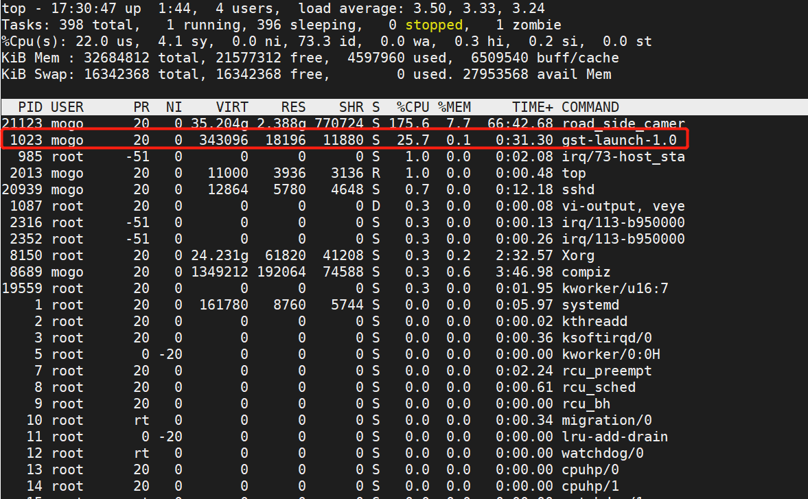

    • veye相机cpu的使用情况
      cpu的占用正常吗

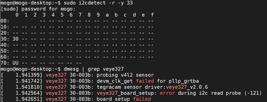

    • RE: 签名文件
      应该怎么输入address 的参数

    • RE: 签名文件
      @veye_xumm said in 签名文件:
      看这个信息,你应该是只插了两个fpdlink摄像头,然后成功了。挂载在i2c bus 33, address 分别是3b和3c。
      恭喜你!
      真不容易,终于成功了。谢谢!再问一句,i2c bus 33指的什么?
      posted in FPD LINK III Camera

    • RE: 签名文件
      上面还有报错,但是出现了Wiki中提到的内容!不知道这样是不是ok了?你帮忙给看一下

      mogo@mogo-desktop:~$ dmesg | grep veye327
      [ 1.941399] veye327 30-003b: probing v4l2 sensor
      [ 1.941742] veye327 30-003b: devm_clk_get failed for pllp_grtba
      [ 1.941810] veye327 30-003b: tegracam sensor driver:veye327_v2.0.6
      [ 1.942564] veye327 30-003b: veye327_board_setup: error during i2c read probe (-121)
      [ 1.942651] veye327 30-003b: board setup failed
      [ 1.942741] veye327: probe of 30-003b failed with error -121
      [ 1.942775] veye327 30-003c: probing v4l2 sensor
      [ 1.942901] veye327 30-003c: devm_clk_get failed for pllp_grtba
      [ 1.942992] veye327 30-003c: couldn't create debugfs
      [ 1.942997] veye327 30-003c: tegracam sensor driver:veye327_v2.0.6
      [ 1.943657] veye327 30-003c: veye327_board_setup: error during i2c read probe (-121)
      [ 1.943729] veye327 30-003c: board setup failed
      [ 1.943792] veye327: probe of 30-003c failed with error -121
      [ 1.943824] veye327 31-003b: probing v4l2 sensor
      [ 1.943936] veye327 31-003b: devm_clk_get failed for pllp_grtba
      [ 1.943991] veye327 31-003b: tegracam sensor driver:veye327_v2.0.6
      [ 1.944593] veye327 31-003b: veye327_board_setup: error during i2c read probe (-121)
      [ 1.944664] veye327 31-003b: board setup failed
      [ 1.944731] veye327: probe of 31-003b failed with error -121
      [ 1.944761] veye327 31-003c: probing v4l2 sensor
      [ 1.944869] veye327 31-003c: devm_clk_get failed for pllp_grtba
      [ 1.944926] veye327 31-003c: couldn't create debugfs
      [ 1.944952] veye327 31-003c: tegracam sensor driver:veye327_v2.0.6
      [ 1.945589] veye327 31-003c: veye327_board_setup: error during i2c read probe (-121)
      [ 1.945670] veye327 31-003c: board setup failed
      [ 1.945756] veye327: probe of 31-003c failed with error -121
      [ 1.945788] veye327 32-003b: probing v4l2 sensor
      [ 1.945871] veye327 32-003b: devm_clk_get failed for pllp_grtba
      [ 1.945927] veye327 32-003b: tegracam sensor driver:veye327_v2.0.6
      [ 1.946580] veye327 32-003b: veye327_board_setup: error during i2c read probe (-121)
      [ 1.946651] veye327 32-003b: board setup failed
      [ 1.946711] veye327: probe of 32-003b failed with error -121
      [ 1.946741] veye327 32-003c: probing v4l2 sensor
      [ 1.946815] veye327 32-003c: devm_clk_get failed for pllp_grtba
      [ 1.946872] veye327 32-003c: couldn't create debugfs
      [ 1.946877] veye327 32-003c: tegracam sensor driver:veye327_v2.0.6
      [ 1.947473] veye327 32-003c: veye327_board_setup: error during i2c read probe (-121)
      [ 1.947587] veye327 32-003c: board setup failed
      [ 1.947646] veye327: probe of 32-003c failed with error -121
      [ 1.947700] veye327 33-003b: probing v4l2 sensor
      [ 1.947785] veye327 33-003b: devm_clk_get failed for pllp_grtba
      [ 1.947912] veye327 33-003b: tegracam sensor driver:veye327_v2.0.6
      [ 1.948527] veye327 33-003b: veye327_board_setup: error during i2c read probe (-121)
      [ 1.948596] veye327 33-003b: board setup failed
      [ 1.948656] veye327: probe of 33-003b failed with error -121
      [ 1.948686] veye327 33-003c: probing v4l2 sensor
      [ 1.948757] veye327 33-003c: devm_clk_get failed for pllp_grtba
      [ 1.948814] veye327 33-003c: couldn't create debugfs
      [ 1.948818] veye327 33-003c: tegracam sensor driver:veye327_v2.0.6
      [ 1.949431] veye327 33-003c: veye327_board_setup: error during i2c read probe (-121)
      [ 1.949512] veye327 33-003c: board setup failed
      [ 1.949574] veye327: probe of 33-003c failed with error -121
