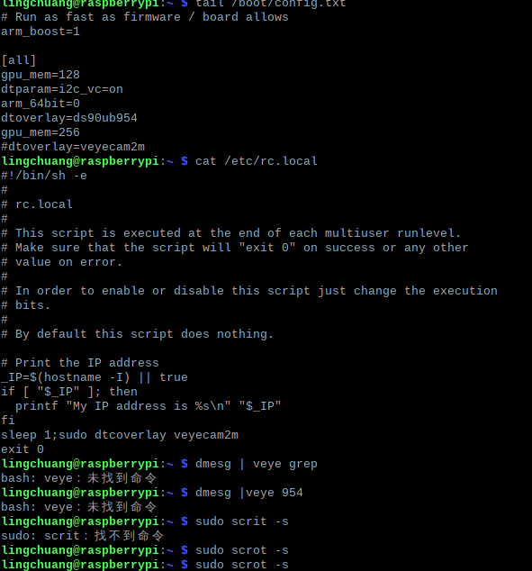

    • RE: CS-FPD-CAM-IMX327摄像头树莓派驱动模式连接不成功
      @veye_xumm lingchuang@raspberrypi:~ $ tail /boot/config.txt
      Run as fast as firmware / board allows
      arm_boost=1
      [all]
      gpu_mem=128
      dtparam=i2c_vc=on
      arm_64bit=0
      dtoverlay=ds90ub954
      gpu_mem=256
      #dtoverlay=veyecam2m
      lingchuang@raspberrypi:~ $ cat /etc//rc.local
      #!/bin/sh -e
      rc.local
      This script is executed at the end of each multiuser runlevel.
      Make sure that the script will "exit 0" on success or any other
      value on error.
      In order to enable or disable this script just change the execution
      bits.
      By default this script does nothing.
      Print the IP address
      _IP=$(hostname -I) || true
      if [ "$_IP" ]; then
      printf "My IP address is %s\n" "$_IP"
      fi
      sleep 1;sudo dtcoverlay veyecam2m
      exit 0
      lingchuang@raspberrypi:~ $ dmesg |grep veye
      lingchuang@raspberrypi:~ $ dmesg |grep 954

      刚子
      @veye_xumm 2023-06-12-175402_591x634_scrot.png 重启后就是这个状态了
      posted in CS MIPI camera
