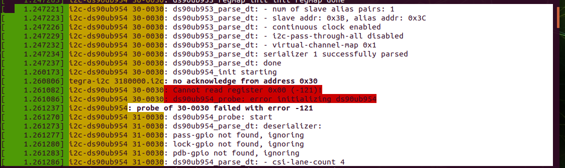

      @chjchoi On the last photos .. the chip information and not important to functioning.
      So iwill block the error and will go ahead of test.

      Dear,
      Do you have any ideas on the attached photo image?
      first time ds90ub954 has successed but at the point it fails to access to 0x30 and
      it causes camera drivers access failure I think.
      posted in FPD LINK III Camera
