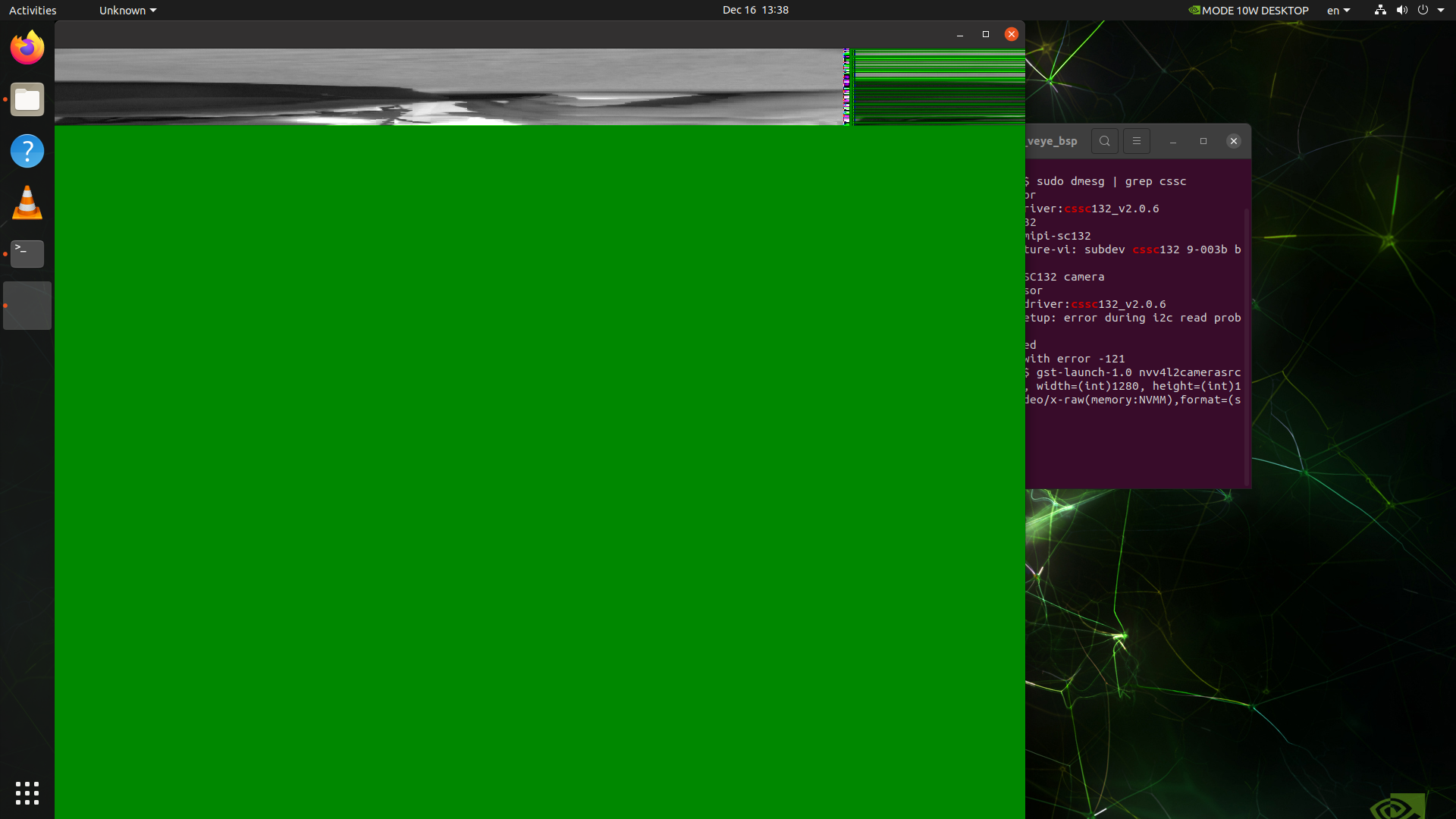

@dmmoskalev I recorded the screen with bad sync during GStream running
[https://disk.yandex.ru/i/LfOs8kLEuRhICg](link url) -

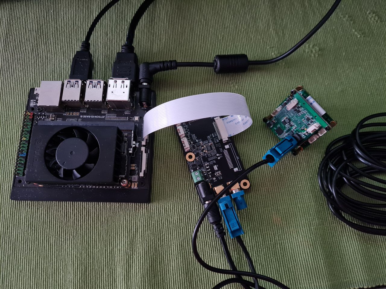

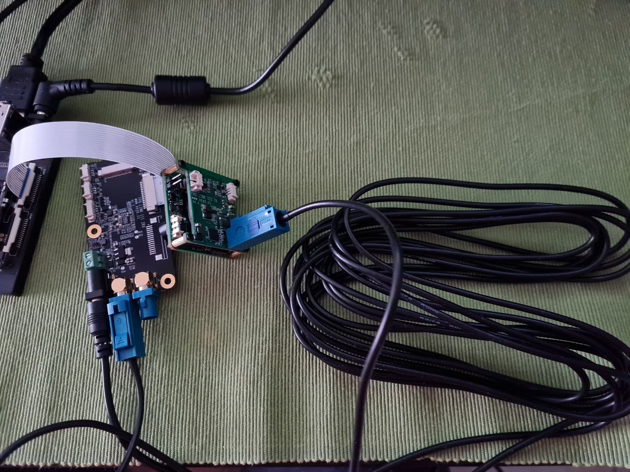

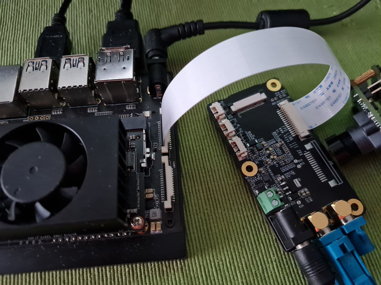

@veye_xumm FPD Link cable is 5m length. The photo of connections:
On the week I made additional research and noticed that my CS-MIPI-SC132 has wrong values in memory. For example, I tried to read all settings according http://wiki.veye.cc/index.php/CS-MIPI-X_i2c (pp5.3 - 5.33) but returned values were only 1 or 257 (depends on one or two bytes: 0000 0001 0000 0001 were reading). I tried to write the proper values in registers and read it in next cmd. Write cmd report was successful, but read cmd returned wrong values again. So I suspect the firmware in my SC132 cam need to be updated.
My next assumption about ISP in SC132 board. I suppose in my case the ISP does not work properly and as a result it not generate H,V sync to FPD Link serializer that is why there is no synchronization on image. FFMPEG and GStreamer give the error messages about abnormal framerate. But when I connect the same SC132 with the same flat cable to Jetson NX directly the image is OK, because on the Jetson board the internal ISP module get camera stream and detect sync signals correct.
How do you think, can the SC132 firmware update solve the problem? -
