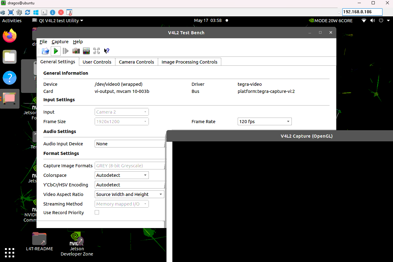

    • [AR0234M][XavierNX][JP5.1.4] Upgrading from 2 lanes to 4 lanes
      Hello!
      I've recently bought a RAW-MIPI-AR0234M for image processing in a UAV project.
      I've followed the steps presented here How to upgrade the Jetson system to support VEYE cameras and everything was working fine up till the point where i've decided to move from 2 lanes to 4 lanes.
      When i switched from 2 lanes to 4 lanes using the i2c tool provided in the git repo and opened qv4l2 i realized that something is wrong: no image was being displayed by the program.
      I will start by sharing the firmware version of the camera and my current setup:

      After opening qv4l2:
      [  318.004980] mvcam 10-003b: csi2_try format
      [  329.616728] mvcam 10-003b: csi2_try format
      [  329.616772] mvcam 10-003b: csi2_try format
      [  329.616784] mvcam 10-003b: mvcam_csi2_get_fmt_idx_by_code success
      [  329.700934] mvcam 10-003b: camera_common_mclk_enable: no device power rail
      [  329.701173] mvcam 10-003b: camera_common_s_power: failed to enable mclk
      [  332.763065] tegra-camrtc-capture-vi tegra-capture-vi: uncorr_err: request timed out after 2500 ms
      [  332.763380] tegra-camrtc-capture-vi tegra-capture-vi: err_rec: attempting to reset the capture channel
      [  332.763671] (NULL device *): vi_capture_control_message: NULL VI channel received
      [  332.763991] t194-nvcsi 13e10000.host1x:nvcsi@15a00000: csi5_stream_close: Error in closing stream_id=2, csi_port=2
      [  332.764210] (NULL device *): vi_capture_control_message: NULL VI channel received
      [  332.764788] tegra-camrtc-capture-vi tegra-capture-vi: err_rec: successfully reset the capture channel
      [  332.810983] [RCE] ERROR: camera-ip/vi5/vi5.c:3893 [vi5_update_channel_match_data] "match configuration is already in use by by channel 35 cannot set channel match configuration"
      [  332.810996] [RCE] ERROR: services/capture/capture-scheduler.c:3024 [capture_scheduler_thread] "Error processing event 0x100003"
      [  335.322272] tegra-camrtc-capture-vi tegra-capture-vi: uncorr_err: request timed out after 2500 ms
      [  335.322565] tegra-camrtc-capture-vi tegra-capture-vi: err_rec: attempting to reset the capture channel
      [  335.322792] (NULL device *): vi_capture_control_message: NULL VI channel received
      [  335.322953] t194-nvcsi 13e10000.host1x:nvcsi@15a00000: csi5_stream_close: Error in closing stream_id=2, csi_port=2
      [  335.323169] (NULL device *): vi_capture_control_message: NULL VI channel received
      [  335.323328] t194-nvcsi 13e10000.host1x:nvcsi@15a00000: csi5_stream_open: VI channel not found for stream- 2 vc- 0
      [  335.323905] tegra-camrtc-capture-vi tegra-capture-vi: err_rec: successfully reset the capture channel
      [  337.881490] tegra-camrtc-capture-vi tegra-capture-vi: uncorr_err: request timed out after 2500 ms
      [  337.881759] tegra-camrtc-capture-vi tegra-capture-vi: err_rec: attempting to reset the capture channel
      [  337.881999] (NULL device *): vi_capture_control_message: NULL VI channel received
      [  337.882162] t194-nvcsi 13e10000.host1x:nvcsi@15a00000: csi5_stream_close: Error in closing stream_id=2, csi_port=2
      [  337.882379] (NULL device *): vi_capture_control_message: NULL VI channel received
      [  337.882543] t194-nvcsi 13e10000.host1x:nvcsi@15a00000: csi5_stream_open: VI channel not found for stream- 2 vc- 0
      [  337.883104] tegra-camrtc-capture-vi tegra-capture-vi: err_rec: successfully reset the capture channel
      [  337.901475] [RCE] ERROR: camera-ip/vi5/vi5.c:3893 [vi5_update_channel_match_data] "match configuration is already in use by by channel 35 cannot set channel match configuration"
      [  337.901488] [RCE] ERROR: services/capture/capture-scheduler.c:3024 [capture_scheduler_thread] "Error processing event 0x100003"
      I'm suspecting that I did something wrong during the setup.
      Has anyone faced a similar issue or has any idea how to properly upgrade from 2-lane to 4-lane bus on JP5.14?
      posted in Jetson App Software
