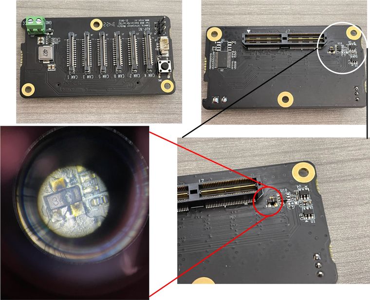

    • RE: ADP-N1-V2.0 Adapter Board
      @veye_xumm Hello,
      I replaced BLM3401 on my ADP-N1-V2.0 Adapter Board and also made sure the board does't short. Please see attached images.
      Unfortunately, my adaptor board gets really really hot a few seconds after connecting to jetson!

    • ADP-N1-V2.0 Adapter Board
      I have a Jetson AGX Orin which connect to power supply using the USB-C connector.
      I ordered IMX335 which came with ADP-N1-V2.0 Adapter board. When I connected the adaptor to the Jetson board, one component got burned. I didn't connect the adaptor to any power supply.
      Please attached images.
