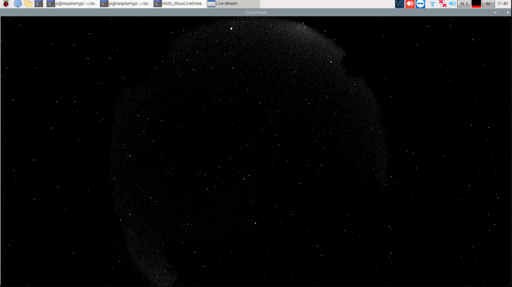

      Attached is a test shot. This particular shot has been taken at new_mgain=30 and 1 sec exposure, we do see ~30 bright hot pixels already at new_mgain=25 and 40 ms exposure.
      Since this is fish eye shot, stars are to be expected only in the brighter circular area in the middle.
      blocking the lens, we see the stars vanish and only the hot pixels remain.

    • VEYE-MIPI-IMX385 hot pixels
      Hello,
      during nighttime operation we noticed quite a large amount of hot pixels at gain values ≥ 25. Additionally, it seems like pixels below a certain brightness threshold get set to black? We believe this because objects in the foreground are clearly visible, but anything beyond approximately 2 meters becomes almost imperceptible.
      This is a script used to set the i2c parameters:
      ./veye_mipi_i2c.sh -w -f videoformat -p1 PAL
      sleep 1
      ./veye_mipi_i2c.sh -w -f sharppen -p1 0
      sleep 0.2
      ./veye_mipi_i2c.sh -w -f irtrigger -p1 0
      sleep 0.2
      ./veye_mipi_i2c.sh -w -f lowlight -p1 0x00 #fixed 25 fps
      sleep 0.2
      ./veye_mipi_i2c.sh -w -f wdrmode -p1 0x00 #back light mode off
      sleep 0.2
      ./veye_mipi_i2c.sh -w -f wdrtargetbr -p1 0xff #for wdrmode 0x03
      sleep 0.2
      ./veye_mipi_i2c.sh -w -f denoise -p1 0x00
      sleep 0.2
      ./veye_mipi_i2c.sh -w -f daynightmode -p1 0xfe #Black and White mode
      sleep 0.2
      ./veye_mipi_i2c.sh -w -f new_expmode -p1 1
      sleep 0.2
      ./veye_mipi_i2c.sh -w -f new_mshutter -p1 100000  # in µs
      sleep 0.2
      ./veye_mipi_i2c.sh -w -f new_mgain -p1 45 #0.1 - 0.3
      sleep 0.2
      ./veye_mipi_i2c.sh -w -f brightness -p1 0x00
      Does anyone have some advice as to why this could be and how to fix it?
