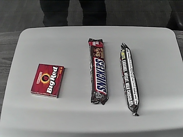

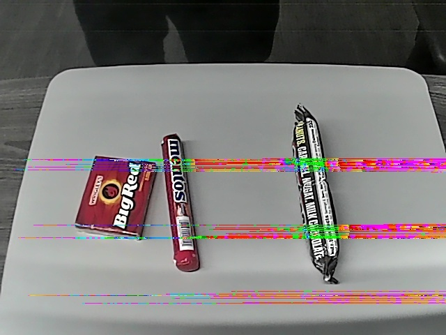

      Hello,
      Thanks for the reply. We will check with a different FFC cable and give you updates.

    • VEYE IMX-307 MIPI CSI camera Freeze and Interference Issue
      Hello,
      We are using IMX-307 CSI cameras and we are facing some freezing and interference issues (Image captured by the camera has some colored lines in random spots).
      1. Camera freezes randomly and the image is stuck at a certain point and we have to re run the program or reboot the system to fix it. Only one of the 3 cameras we are using has this freezing issue.
      2. Interference appears randomly. However, it only lasts for few seconds and goes away.
      Here's an image without interference -
      Same image with interference -
      Need help looking into these issues. Thanks
