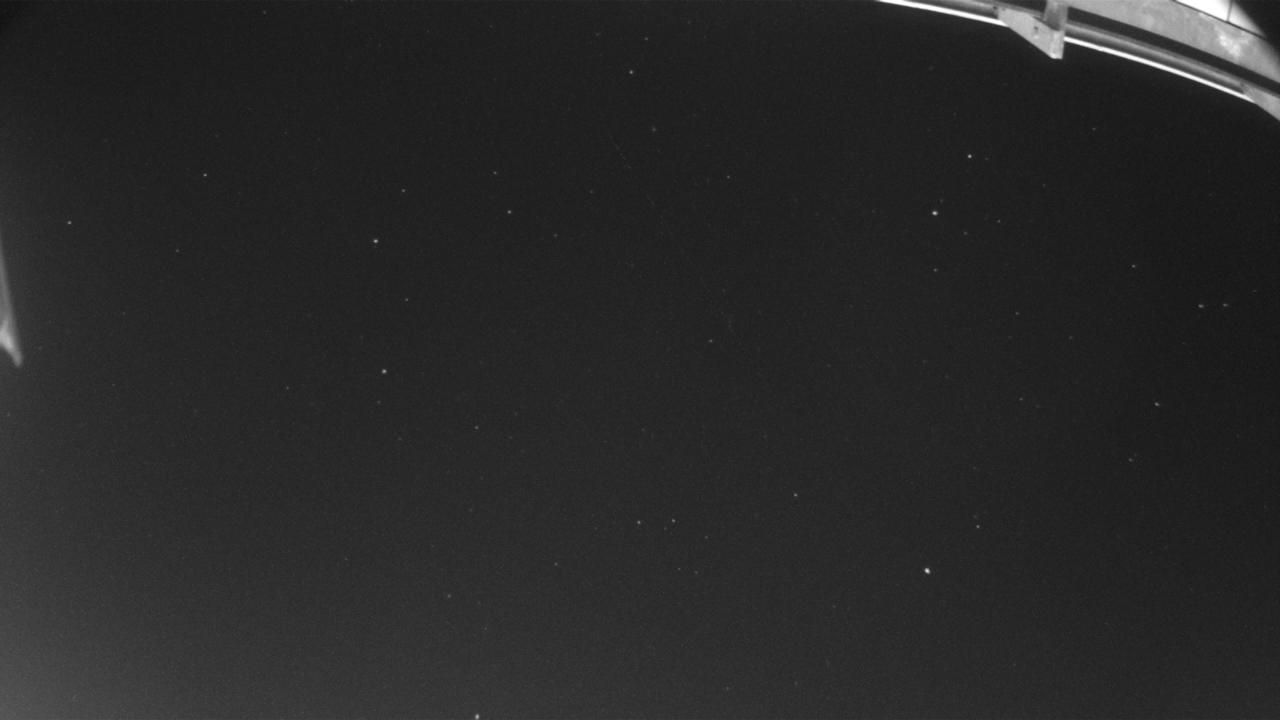

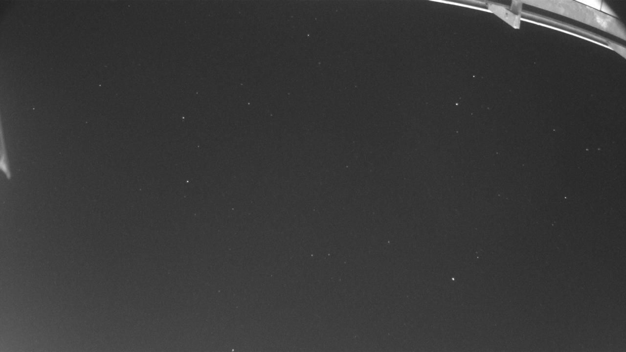

      FF_CZ0004_20230315_204426_226_0277248.fits_maxpixel.jpg FF_CZ0004_20230315_204416_011_0276992.fits_maxpixel.jpg

      Another change has been detected last night, around 20:44:25 UTC.
      Unfortunatelly, no change detected in spoken registers.
      The reading interval was set to 5 seconds.
      I am also attaching two full BMP images just before/after the change of brightness.![1_1678948719448_FF_CZ0004_20230315_204426_226_0277248.fits_maxpixel.bmp](Nahrávám 100%) ![0_1678948719448_FF_CZ0004_20230315_204416_011_0276992.fits_maxpixel.bmp](Nahrávám 100%)
      03/15/2023 20:44:11 reg addr 0x14 val is 0x53
      03/15/2023 20:44:11 reg addr 0x20 val is 0x1
      03/15/2023 20:44:11 reg addr 0x21 val is 0x0
      03/15/2023 20:44:11 reg addr 0x22 val is 0x0
      03/15/2023 20:44:12 reg addr 0x9 val is 0x11
      03/15/2023 20:44:17 reg addr 0x14 val is 0x53
      03/15/2023 20:44:17 reg addr 0x20 val is 0x1
      03/15/2023 20:44:18 reg addr 0x21 val is 0x0
      03/15/2023 20:44:18 reg addr 0x22 val is 0x0
      03/15/2023 20:44:18 reg addr 0x9 val is 0x11
      03/15/2023 20:44:24 reg addr 0x14 val is 0x53
      03/15/2023 20:44:24 reg addr 0x20 val is 0x1
      03/15/2023 20:44:24 reg addr 0x21 val is 0x0
      03/15/2023 20:44:25 reg addr 0x22 val is 0x0
      03/15/2023 20:44:25 reg addr 0x9 val is 0x11
      03/15/2023 20:44:30 reg addr 0x14 val is 0x53
      03/15/2023 20:44:30 reg addr 0x20 val is 0x1
      03/15/2023 20:44:31 reg addr 0x21 val is 0x0
      03/15/2023 20:44:31 reg addr 0x22 val is 0x0
      03/15/2023 20:44:31 reg addr 0x9 val is 0x11
      03/15/2023 20:44:36 reg addr 0x14 val is 0x53
      03/15/2023 20:44:37 reg addr 0x20 val is 0x1
      03/15/2023 20:44:37 reg addr 0x21 val is 0x0
      03/15/2023 20:44:37 reg addr 0x22 val is 0x0
      03/15/2023 20:44:38 reg addr 0x9 val is 0x11
      03/15/2023 20:44:43 reg addr 0x14 val is 0x53
      03/15/2023 20:44:43 reg addr 0x20 val is 0x1
      03/15/2023 20:44:43 reg addr 0x21 val is 0x0
      03/15/2023 20:44:44 reg addr 0x22 val is 0x0
      03/15/2023 20:44:44 reg addr 0x9 val is 0x11
