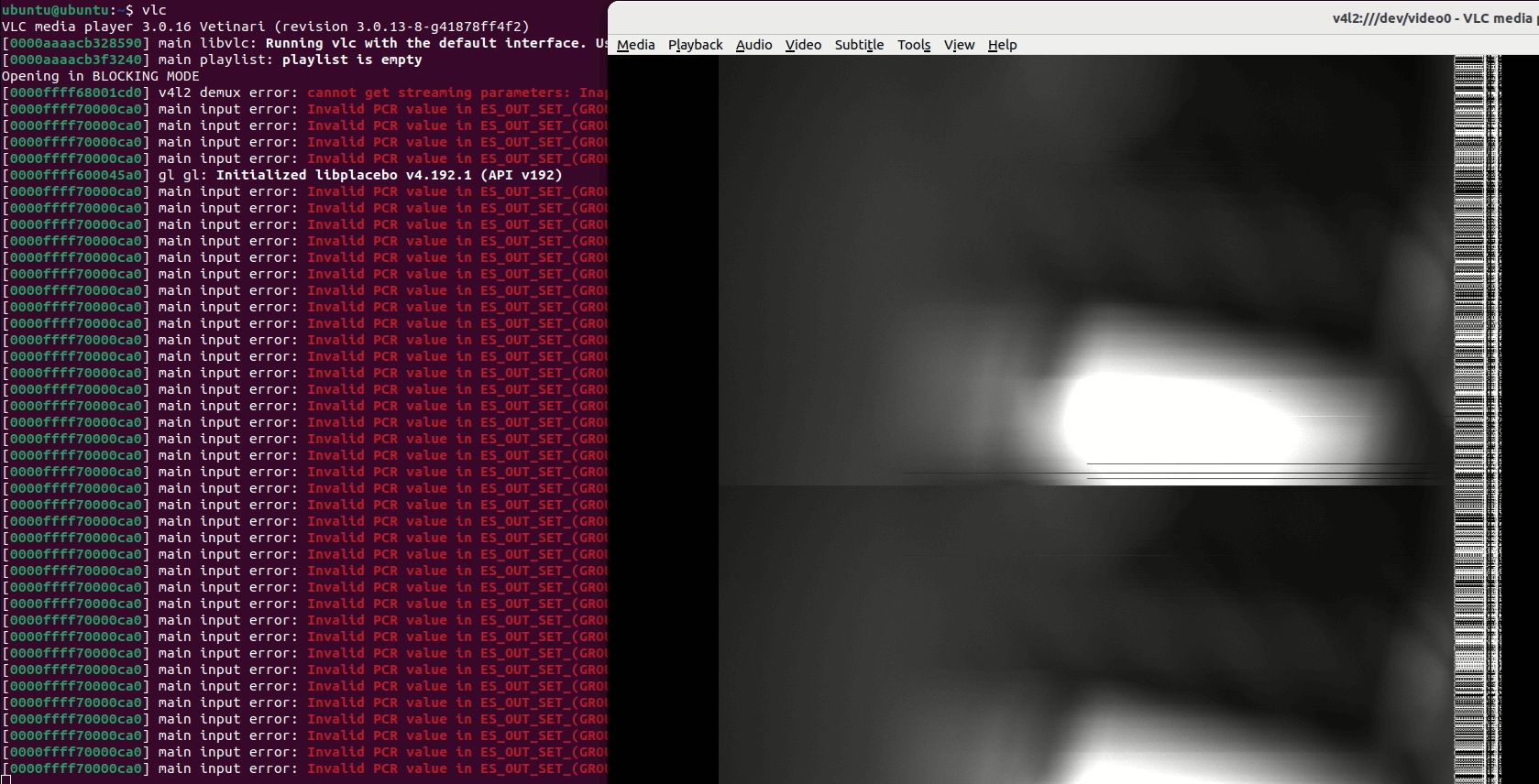

Thank you very much for the reply, it really helped! I followed the recommendations faithfully and successfully completed the installation. However, I'm facing a problem:
The camera generates an image with errors and very low fps, as shown in the attached image:
Attached is the sudo dmesg: ubuntu@ubuntu~$ sudo dmesg.txt
