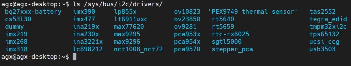

      @veye_xumm 但是驱动都已经显示装上了呀
      agx@agx-desktop:~$ ls /proc/device-tree/i2c@3180000/tca9548@70/i2c@*
      /proc/device-tree/i2c@3180000/tca9548@70/i2c@0:
      '#address-cells' i2c-mux,deselect-on-exit name reg '#size-cells' veye327_a@3b
      /proc/device-tree/i2c@3180000/tca9548@70/i2c@1:
      '#address-cells' i2c-mux,deselect-on-exit name reg '#size-cells' veye327_b@3b
      /proc/device-tree/i2c@3180000/tca9548@70/i2c@2:
      '#address-cells' i2c-mux,deselect-on-exit name reg '#size-cells' veye327_c@3b
      /proc/device-tree/i2c@3180000/tca9548@70/i2c@3:
      '#address-cells' i2c-mux,deselect-on-exit name reg '#size-cells' veye327_d@3b
      /proc/device-tree/i2c@3180000/tca9548@70/i2c@4:
      '#address-cells' i2c-mux,deselect-on-exit name reg '#size-cells' veye327_e@3b
      /proc/device-tree/i2c@3180000/tca9548@70/i2c@5:
      '#address-cells' name '#size-cells' veye327_g@3b
      i2c-mux,deselect-on-exit reg veye327_f@3b
      agx@agx-desktop:~$ ls /sys/bus/i2c/drivers/
      bq27xxx-battery imx390 max9295 'PEX9749 thermal sensor' tps65132
      cs53l30 imx477 max9296 rt5640 ucsi_ccg
      cssc132 ina219x nct1008_nct72 rt5659 usb3503
      csx307 ina230x ov10823 rtc-rx8025 veye327
      dummy ina3221x ov23850 sgtl5000 veyecam
      i2c-ds90ub954 lc898212 ov9281 stepper_pca
      imx219 lp855x pca953x tas2552
      imx268 lt6911uxc pca954x tegra_edid
      imx318 max77620 pca9570 tmpm32xi2c

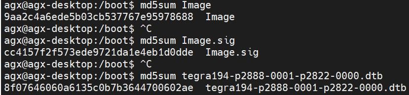

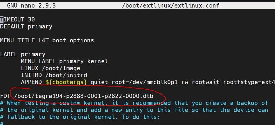

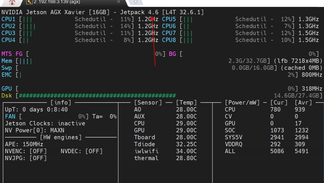

    • Xavier AGX Jetpack4.6不能刷入MPI327相机驱动
      AGX+原装0001主板,刚刚使用SDK Manager刷入的4.6系统,什么软件都没有安装
      写入Image等3个文件到boot,并添加FDT命令,但无法找到驱动,
      降级为4.5.1则驱动刷入正常
      这是4.6系统的刷入截图
      更奇怪的是把boot文件夹改为boot.old后系统仍能启动,怀疑是4.6系统的双rootfs功能启动了
      但无论如何都无法刷入驱动,刷4.6安驱动失败,降级4.5.1安驱动成功,再次刷4.6安驱动,还是失败,(都是下载的对应版本的Image文件,具体可见图中的md5sum),搞了10多个小时了,精疲力尽
