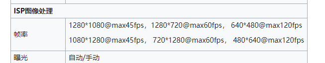

      http://wiki.veye.cc/index.php/CS-MIPI-SC132_Data_Sheet/zh
      只有这几种模式。
      试试这个
      gst-launch-1.0 nvv4l2camerasrc ! "video/x-raw(memory:NVMM),format=(string)UYVY, width=(int)1280, height=(int)1080, framerate=(fraction)45/1" ! nvvidconv ! "video/x-raw(memory:NVMM),format=(string)I420" ! nvoverlaysink sync=false
