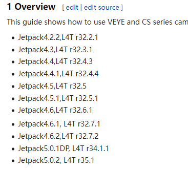

                  http://wiki.veye.cc/index.php/VEYE_CS_Camera_for_Jetson_TX2
                  For the original system version of the motherboard, we have provided the corresponding Image and dtb. But Jetpack 4.6.3 is the version that just came out and we haven't had time to port the driver yet.
                  We suggest you to re-burn the motherboard to Jetpack4.6.2 first, then use the corresponding Image and dtb.
