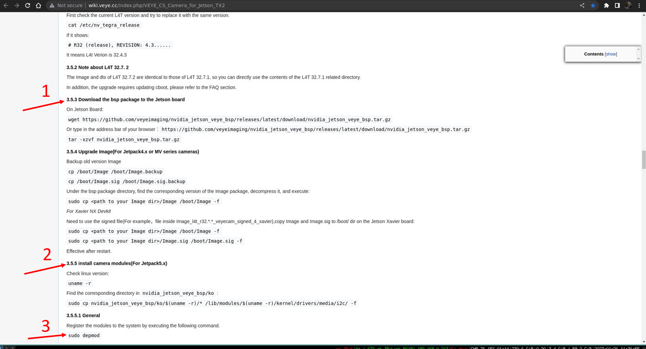

      We are using VEYE IMX-307 MIPI CSI camera and camera interposer module (http://www.veye.cc/en/product/cs-tx2-xavier-ncam-imx307/) with Jetson Orin 32GB. Here’s the link to the camera drivers - (http://wiki.veye.cc/index.php/VEYE_CS_Camera_for_Jetson_TX2)

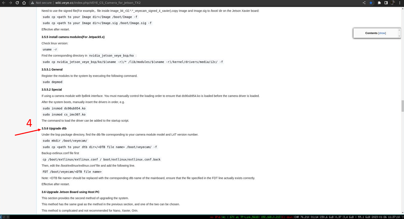

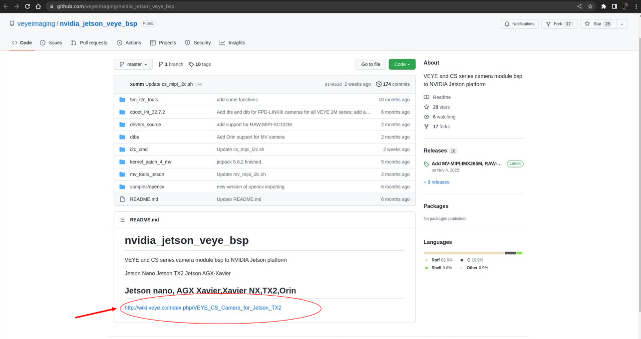

      Interposer module and the cameras were working perfectly fine with Jetpack 5.0.1 DP. We followed the below steps -

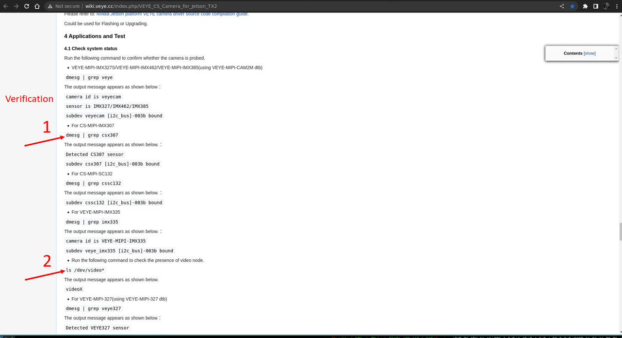

      However, Jetpack 5.0.1 DP has been discontinued by Nvidia. With Jetpack 5.0.2, we are able to install camera and the interposer module drivers without any errors. However the system is unable to recognize the interposer module and the cameras (Verification steps in shown in the picture above gives not output).
      Need assistance in installation of drivers in Jetpack 5.0.2.

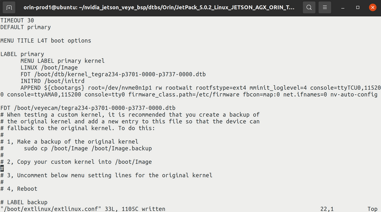

          Here's the updated content of /boot/extlinux/extlinux.conf

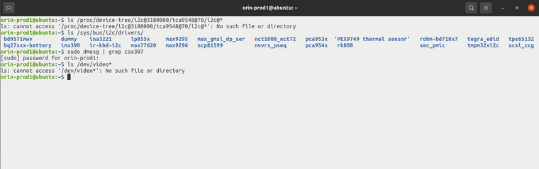

          After installation we rebooted the system and executed the below commands (Section 3.7)
