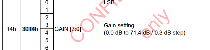

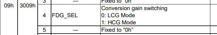

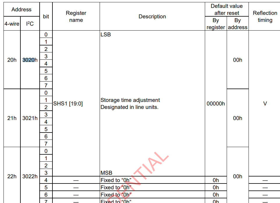

                      I have provided a script in the attachment which can read the sensor registers.
                      Can you please add a monitoring program in your system to monitor the following registers of the sensor: 0x14, 0x20, 0x21, 0x22, and 0x09.
                      The usage of the script is: ./veye_inner.sh -r -f sns_reg -p1 [sns_reg_addr].
                      Especially pay attention to whether the registers of the sensor have changed when a sudden change in brightness is detected.
                      veye_inner.sh.txt
                      M 1 Reply Last reply Reply Quote 0
                      • M
                        milank @veye_xumm last edited by
                        fine, understood, now it is running in the background for spoken registers.
                        I will come back with the results once I see the spike again.

                          Another change has been detected last night, around 20:44:25 UTC.
                          Unfortunatelly, no change detected in spoken registers.
                          The reading interval was set to 5 seconds.
                          I am also attaching two full BMP images just before/after the change of brightness.![1_1678948719448_FF_CZ0004_20230315_204426_226_0277248.fits_maxpixel.bmp](Nahrávám 100%) ![0_1678948719448_FF_CZ0004_20230315_204416_011_0276992.fits_maxpixel.bmp](Nahrávám 100%)
                          03/15/2023 20:44:11 reg addr 0x14 val is 0x53
                          03/15/2023 20:44:11 reg addr 0x20 val is 0x1
                          03/15/2023 20:44:11 reg addr 0x21 val is 0x0
                          03/15/2023 20:44:11 reg addr 0x22 val is 0x0
                          03/15/2023 20:44:12 reg addr 0x9 val is 0x11
                          03/15/2023 20:44:17 reg addr 0x14 val is 0x53
                          03/15/2023 20:44:17 reg addr 0x20 val is 0x1
                          03/15/2023 20:44:18 reg addr 0x21 val is 0x0
                          03/15/2023 20:44:18 reg addr 0x22 val is 0x0
                          03/15/2023 20:44:18 reg addr 0x9 val is 0x11
                          03/15/2023 20:44:24 reg addr 0x14 val is 0x53
                          03/15/2023 20:44:24 reg addr 0x20 val is 0x1
                          03/15/2023 20:44:24 reg addr 0x21 val is 0x0
                          03/15/2023 20:44:25 reg addr 0x22 val is 0x0
                          03/15/2023 20:44:25 reg addr 0x9 val is 0x11
                          03/15/2023 20:44:30 reg addr 0x14 val is 0x53
                          03/15/2023 20:44:30 reg addr 0x20 val is 0x1
                          03/15/2023 20:44:31 reg addr 0x21 val is 0x0
                          03/15/2023 20:44:31 reg addr 0x22 val is 0x0
                          03/15/2023 20:44:31 reg addr 0x9 val is 0x11
                          03/15/2023 20:44:36 reg addr 0x14 val is 0x53
                          03/15/2023 20:44:37 reg addr 0x20 val is 0x1
                          03/15/2023 20:44:37 reg addr 0x21 val is 0x0
                          03/15/2023 20:44:37 reg addr 0x22 val is 0x0
                          03/15/2023 20:44:38 reg addr 0x9 val is 0x11
                          03/15/2023 20:44:43 reg addr 0x14 val is 0x53
                          03/15/2023 20:44:43 reg addr 0x20 val is 0x1
                          03/15/2023 20:44:43 reg addr 0x21 val is 0x0
                          03/15/2023 20:44:44 reg addr 0x22 val is 0x0
                          03/15/2023 20:44:44 reg addr 0x9 val is 0x11
