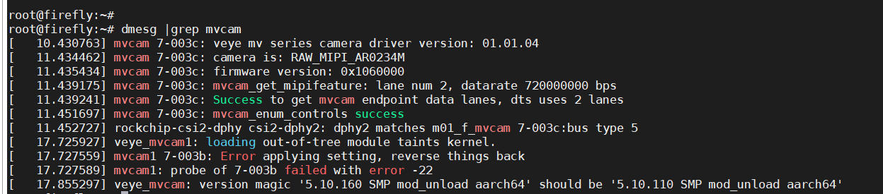

          @veye_xumm 我们做了扩展pcb板,将4通道的dhpy0关闭,扩展成2个两通道的dphy1和dphy2,两个相机单独使用都是可以的,都是连接两个提供的ar0234m驱动就会报错,报错代码如下:
          [ 10.394286] mvcam 7-003c: veye mv series camera driver version: 01.01.04
          [ 11.397980] mvcam 7-003c: camera is: RAW_MIPI_AR0234M
          [ 11.398962] mvcam 7-003c: firmware version: 0x1060000
          [ 11.402539] mvcam 7-003c: mvcam_get_mipifeature: lane num 2, datarate 720000000 bps
          [ 11.402585] mvcam 7-003c: Success to get mvcam endpoint data lanes, dts uses 2 lanes
          [ 11.414798] mvcam 7-003c: mvcam_enum_controls success
          [ 11.415829] rockchip-csi2-dphy csi2-dphy2: dphy2 matches m01_f_mvcam 7-003c:bus type 5
          [ 16.264839] veye_mvcam1: loading out-of-tree module taints kernel.
          [ 16.265429] mvcam1 7-003b: Error applying setting, reverse things back
          [ 16.265445] mvcam1: probe of 7-003b failed with error -22
            veye_xumm @lin last edited by
            @lin said in roc-rk3588s-pc怎么驱动两个ar0234M:
            看起来你的dts触发了一个错误,这个错误是camera相机外的驱动报出的。建议你根据这错误,驱动源码,确定一下问题。
