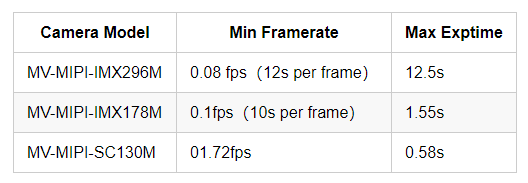

        With today's camera firmware, the exposure time is limited by the minimum frame rate. To achieve long exposures, you first have to configure a very small frame rate, here are our measurements.
