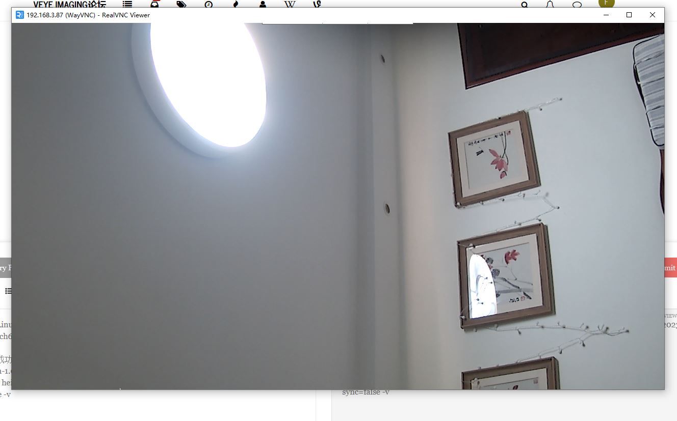

      使用测试成功
      gst-launch-1.0 v4l2src device=/dev/video0 ! "video/x-raw,format=(string)UYVY, width=(int)1920, height=(int)1080,framerate=(fraction)30/1" ! videoconvert ! autovideosink sync=false -v

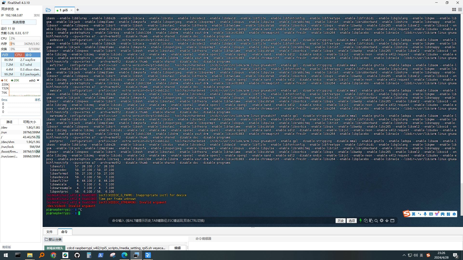

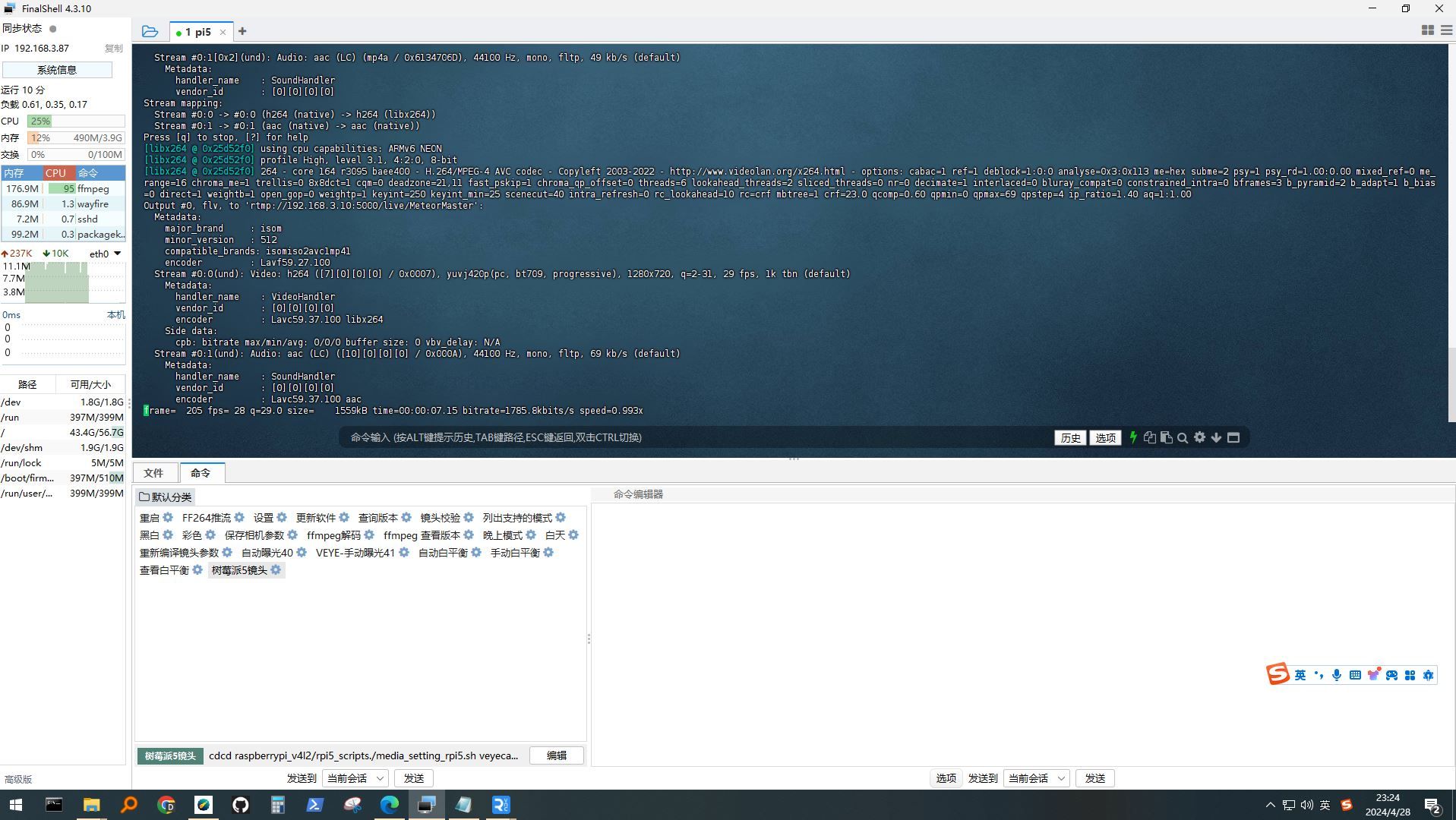

        使用FFMPEG 推流
        ffmpeg -re -i 001.mp4 -c:v libx264 -preset veryfast -c:a aac -f flv rtmp://192.168.3.10:5000/live/MeteorMaster
        正常
        使用镜头推流,出错
        ffmpeg -re -i /dev/video0 -c:v libx264 -preset veryfast -c:a aac -f flv rtmp://192.168.3.10:5000/live/MeteorMaster

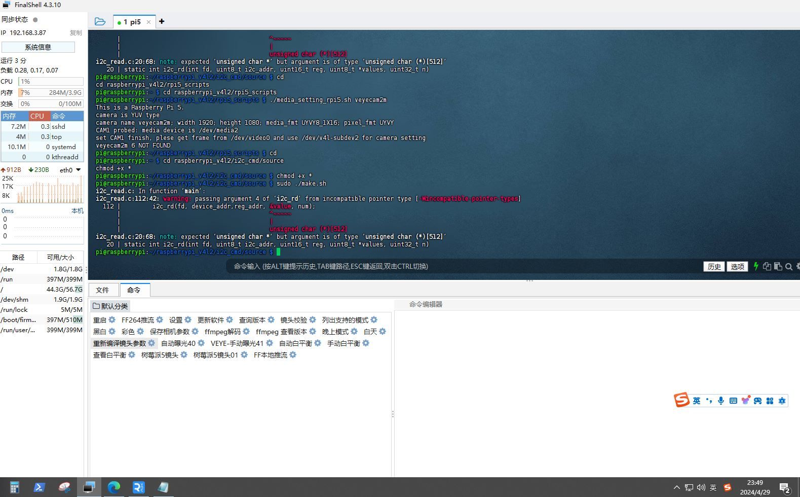

          pi@raspberrypi:~/raspberrypi_v4l2/i2c_cmd/source $ sudo ./make.sh
          问题:
          i2c_read.c: In function ‘main’:
          i2c_read.c:112:42: warning: passing argument 4 of ‘i2c_rd’ from incompatible pointer type [-Wincompatible-pointer-types]
          112 | i2c_rd(fd, device_addr,reg_addr, &value, num);
          | unsigned char (*)[512]
          i2c_read.c:20:68: note: expected ‘unsigned char ’ but argument is of type ‘unsigned char ()[512]’
          20 | static int i2c_rd(int fd, uint8_t i2c_addr, uint16_t reg, uint8_t *values, uint32_t n)
