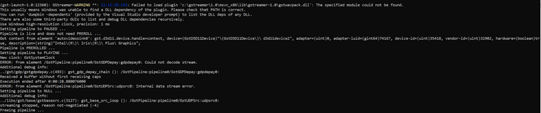

    • VEYE-MIPI-327S gstreamer issue
      Hi,
      I trying to get gstreamer working via UDP
      RPI side
      /home/pi/raspberrypi/veye_raspcam/bin/./veye_raspivid -b 4000000 -t 0 -o -  | gst-launch-1.0 -v fdsrc ! h264parse ! rtph264pay config-interval=1 pt=96 ! gdppay ! udpsink host=192.168.0.208 port=7000 sync=false
      PC side (192.168.0.208:7000)
      gst-launch-1.0 -v udpsrc port=7000 ! gdpdepay ! rtph264depay ! avdec_h264 ! autovideosink sync=false
      I get the following error
      Any help is really appreciated!
