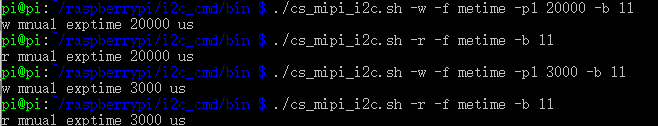

    • RE: CS-MIPI-SC132双相机配置
      @veye_xumm 48d46e9f-8409-40d3-a066-73fd3fa0f407-lADPJxf-vGXXOLrNBQDNA8A_960_1280.jpg 9bc3e035-1e9e-4807-a2b2-7da4eedc1334-lADPJwnIwdK9OL7NBQDNA8A_960_1280.jpg
      posted in CS MIPI camera
